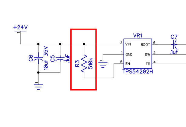

TPS54202 failing @12v input +5 volt at 1 amp output connected to a raspberry pi.
I have designed a board using the application note and the regulator works as expected when first powered up.
I tested the regulator 24 volt input at .5 amp and 1 amp and 1.5 amps with no problems for a 1/2 hour no problems found.
Two regulators have been connected to 24vdc input 1 amp output for 3 days and two of the regulators output went to zero.
The regulator is running cool enough to put my finger on it without burning my skin.  ( I am taking temperature readings now)
Replacing the regulator allows the +5 to come back.  What can I do to fix the regulator burning out.
Can you suggest on how to trouble shoot this problem.
