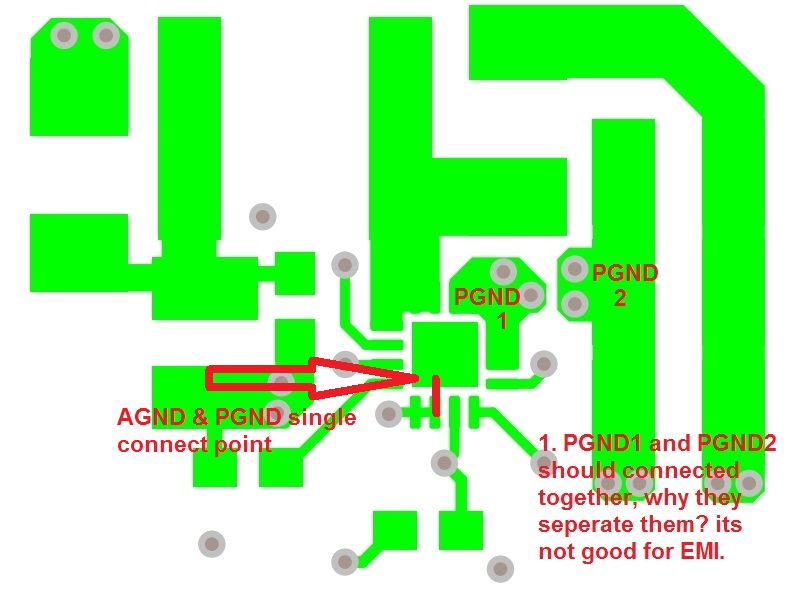

  • The layout is really bad, it seems that they mixed the AGND and the PGND together. I put the suggHelen suggestion.zipestion in the attached file. Please check it.

    The current layout is really poor. there will have EMI problem, this  is why I suspect the problem may caused by the layout. So whether the problem can be solved or not, please change the layout.
  • As what I suggested, please connect the PGND and the AGND at the top layer. Pour the PGND at the top layer, inner layer. Pour the AGND at the bottom since all the control part component at the bottom layer.

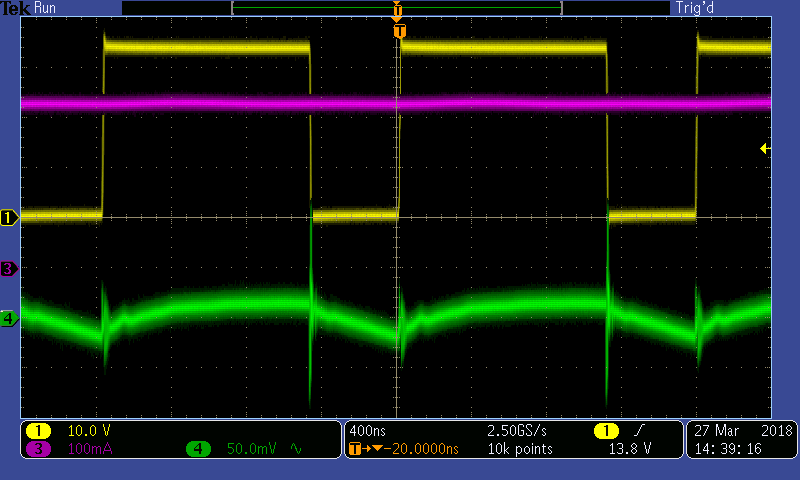

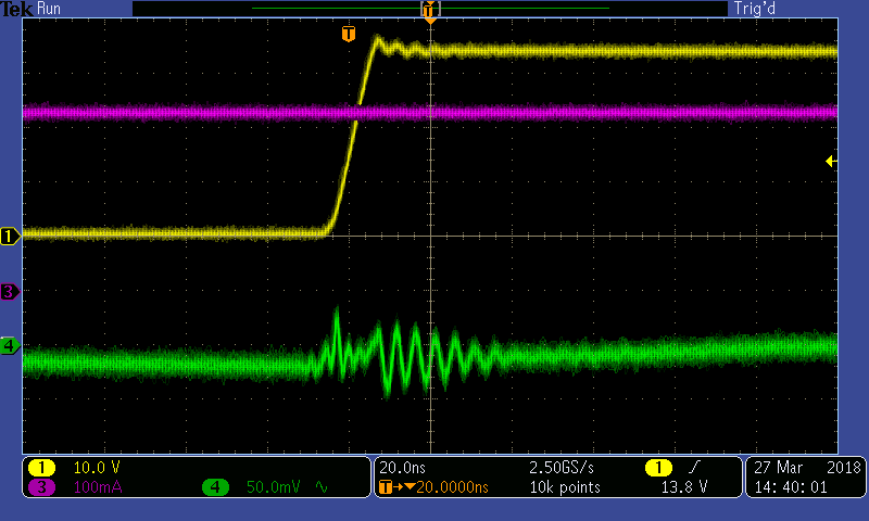

  • I’m a contractor, hired by MP to try and help them with their boost converter. They have shipped me several of their PCBs, both non-working and working, and I’ve seen all of the same issues that you, Antonio and Juan discussed. I’ve done extensive startup and shutdown testing as well as cycling of the EN pin with a signal generator, and I haven’t seen any waveforms that look like they could damage the IC.
    At the end of the chain you were discussing the PCB layout, noting that connection of the AGND, PGND and PowerPAD goes through vias to internal layers instead of connecting on the top layer (where the IC is.) I took one of the working boards and put in some low-inductance test fixtures:
    While I agree that the layout could be improved, the waveforms I see don’t look bad. These were taken at the maximum output current of 330 mA.
         I noticed that you recommended trying different slew rates for the voltage at the EN pin, and that you tested that on a TPS55340 EVM. Is it possible that the added inductance of the vias between the AGND pin and the PowerPAD are causing a latchup in the IC? Since this happens during shutdown, I suppose a fast, negative transient voltage could exist between AGND and the PowerPAD. One thing I did find was that on some of the damaged TPS55340 ICs, if the EN pin was pulled to 24V via the 20k resistor (R66) upon startup, then the TPS would start switching again.
