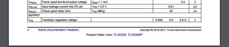

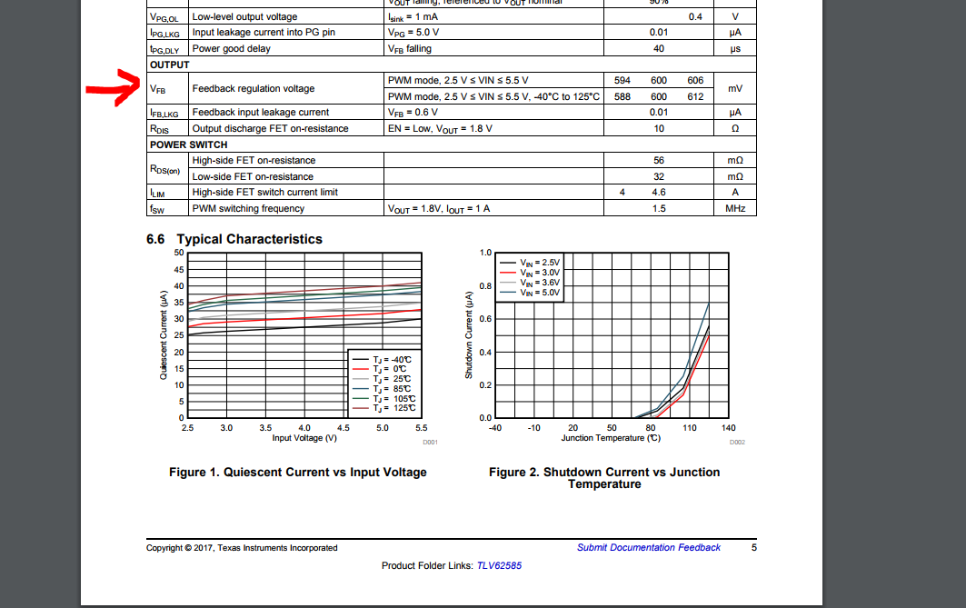

I think what's confusing is the nomenclature. In the datasheet you should search for Vfb, since Vref is an internal voltage, to be precise, while Vfb is the voltage at the feedback pin. Specify the accuracy at Vfb because this is the one which reflects most directly the Vout accuracy.
Anyway, I'll show where it is in the datasheet:
for the TLV62585...
and for the TLV62569...
