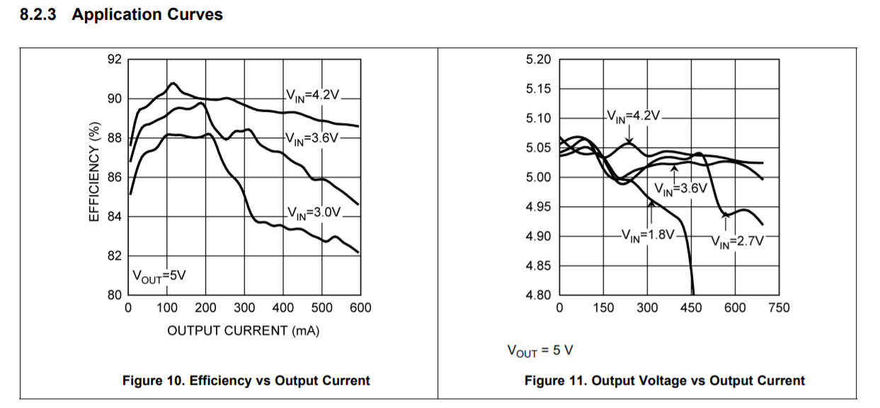

I am building one project, where I need boost converter, that can gives me 2 A at 5 Volts.
I found that IC LM2623 should gives me that 2 A, but in datasheet I found graph:
So can I ask you if it really can gives me 2 A (or at least 1 A) if on its input is 1 Li-Ion cell (input voltage = from 3 V to 4.2 V).
