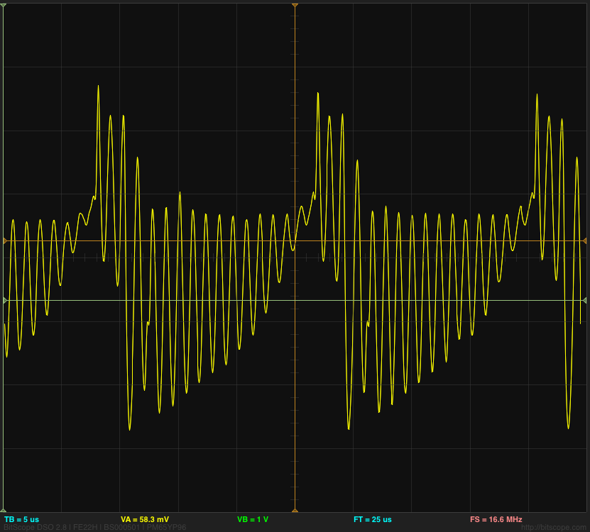

  • For Vin, I have tried: 34.01, 35.01, 36.01, 37.01, 38.01, 39.01, 40.01, 41.01, 42.01, 43.01, 44.01, 45.01, 46.01, 47.01, 48.01, 49.01, 50.01, 51.01, 52.01, 53.01, 54.01 and 55.01 V from a Picotest P9611A. P9611A specs say: < 0.35 mVRMS and < 2 mV p-p.
    For SW1, please explain a rookie more detailed what you need. When SW1 is the leg of the inductor (L1) near M2, there I sometimes see 0.00000V @100kHz. I do see a voltage at the gate of M2: Udc=2.2V and Upp=3.67V. At SW1 on other times I do see: Udc=0.06V, Uac=0.005V, Upp=0.43V;
    While appling power to Vin, there is a short potential visible at the gate of M1. Afterwards the M1 gate voltage stays 0.00000V
  • Bitscope 5 sees this at SW1 (GND=Vin minus pole) @ 50us/Div versus 100mV/Div [Trigger 39.984kHz]:

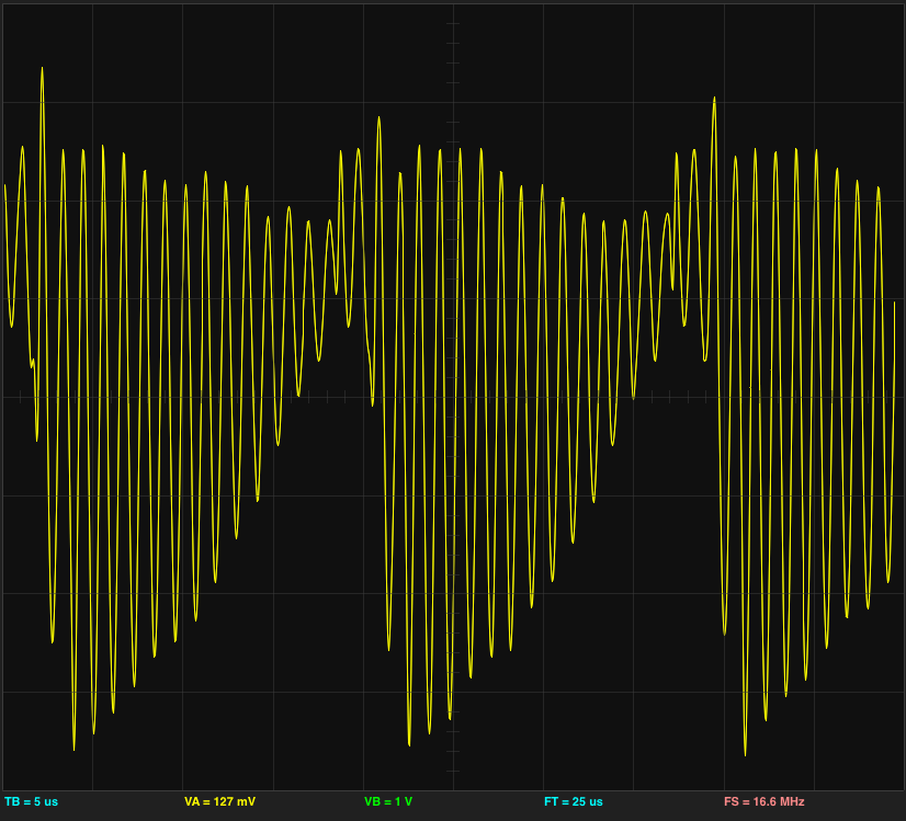

    A little while later Bitscope shows:
    I hope that I understood your request for more information correctly.
  • Thank for providing the waveforms, but sorry this does not help much in debugging. I would like to see the voltage transients caused by peddling. When the circuit was tested on bench, I believe the input power comes from a dc source. When peddling, the generator may create voltage spikes at the VIN rail of the circuit, which is what I would like to see.
    SW1 will be roughly a square wave when switching. Please refer to the datasheet or EVM user guide for a reference of the SW waveforms.
