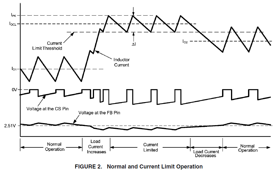

    I want to estimate the Ipk in the figure below.
    Tomoaki Yoshida
  • Hi Tomoaki,
    Currently, a product engineer is looking into the maximum on-time during current limit. I will let you know when he gets back to me.
    Also, yes, you are correct that the on-time will be less than 90ns and becomes 40% of the normal on-time. It will no longer be in normal operation as in the figure you sent, but it will be in current limited operation.
    Thank you.

  • Hi Eric-san,
    Thank you for your reply.
    I calculate ON time from the condition taught is 187.5 ns.
    Ton = (4.1 * 10^(-11) * (RT + 500 Ω)) / VIN +15 ns = 187.5416 ns
    In other words, during the current limit at low temperature, the ON time may reach 70% over 40%.
    This is important information to consider how much margin should be taken.
    Tomoaki Yoshida
  • Hi Tomoaki,
    The Ton equation that you mentioned is based on typical conditions (25degC). Therefore, it might not be accurate for low temperature at -40degC.
    Can you probably elaborate on what you mean by 70% over 40%? I am not sure where this 70% is coming from.
    Thank you.
  • Hi Eric-san,
    Thank you for your support.
    I calculated Ton as 187.5ns in typical conditon as I wrote in the previous post.
    I know it is the design value at typical conditoin and the Ton during normal operation will change under worst conditoin.
    Because the measured maximum Ton at the wotst condition during current limit, I calculated as follows : 138 ns / 187.5 ns = 0.74.
    In order to estimate the maximum peak current roughly, we only want to know the maximum on-time during the current limit and how much to consider margin.
    Since not only the  Ton of LM25011 but also the external components such as the  inductor affects the peak current, we will design with sufficient margin.
    Tomoaki Yoshida
