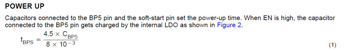

What is the delay time between the Enable signal to the first gate pulse?
