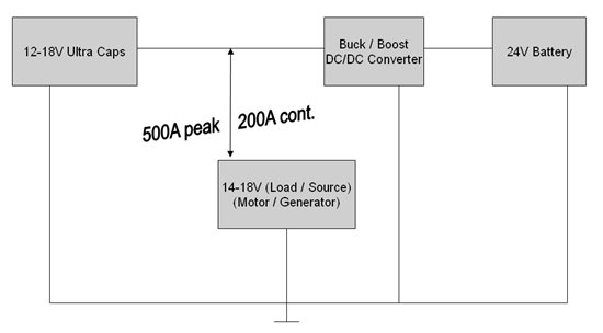

    Let's start by making sure we're both thinking about the same power problem first:
    My understanding is you have an 18V load that needs to be able to draw power selectively from a 12V battery or a 24V battery in 200-500A pulses between 500ms and 1s in length.  Based on that understanding, I proposed this possible solution:

  • Peter,
    actually the topology is a little bit different. Can you imagine which device should probably work out for us? Thanks!

    I have some very good news for your application - A synchronous BUCK power stage will function as a synchronous BOOST Power Stage when the voltage on the output is greater than the target output voltage as long as the controller is able able to handle this configuration and the TPS40140 controller is able to do so.
    If you build a 24V 16-phase synchronous Buck converter with programmable output voltage (or current) to drive your motor and the current needed to maintain that voltage on the motor becomes negative (such as when the motor begins generating power) the BUCK converter will begin drawing current from the motor/generator and forcing it into the battery.
    I don't know the perticulars of your application's control mechanism, but I will start with a Current driven system as its easier to explain.
    You would design a TPS40140 based 16-phase converter, but instead of feeding back the output voltage, you'd feed back a voltage proportional to the motor/generator current plus an offset.  - The offset is used to allow the current to be Positive or Negative.
    When the sensed current needed to get 0.7V at the FB pin is positive, the control loop will force the power stage to operate as a BUCK, driving current into the motor.
    When the sensed current needed to get 0.7V at the FB pin is negative, the control loop will force the power stage to operate as a BOOST, drawing current out of the generator
    The micro-controller can then make adjustments to this feedback circuit to select the mode of operation for the converter.
    In a voltage driven system, the micro-controller would still adjust the feedback, programming an output voltage below the natural electro-motive force of the generator to drawn energy from the generator or above the natural electro-motive force of the generator to force energy into the generator.  Which to use will depend on your motor control scheme.  Whether it's current or voltage driven.
