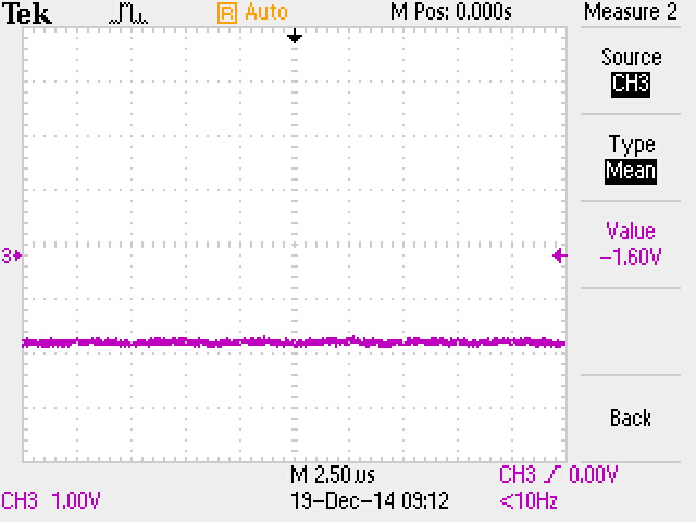

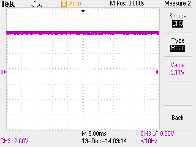

    So, starting from my board:
    this is the input of the voltage inverter TPS60403, directly taken from the Tiva Launchpad USB +5v
    ..and this is what I am getting in its output

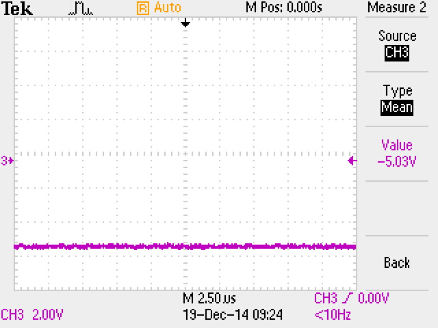

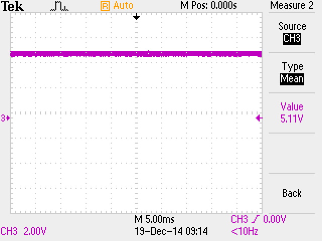

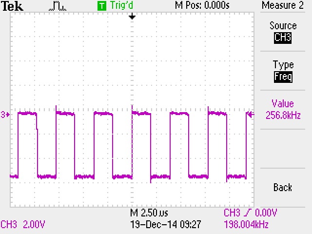

    And now, these are taken from the test system (Tiva Launchpad + ADS1299 demo kit):
    The input is, as before, the Vbus of the Tiva Launchpad.
    TPS60403 output:
    ..and Cfly capacitor
    As I said, it seems that the current absorption after the voltage inverter is now higher than the maximum current deliverable from the TPS60403.
    This is really strange because the -5V goes only to the negative voltage regulator TPS72325. I tried to remove it and the voltage inverter worked well, so I replaced the negative regulator with a new one but, unfortunately, nothing changed.
    Do you have any idea on what is happening?
  • You need to measure the 5V input at the TPS6040x's Vin pin to see the effect of IR drop on your board.
    You could add a 1 Ohm resistor between the TPS6040x output and the LDO input to measure the current flowing. If there is more current on your new board, then you need to debug the LDO's loads and see why they are drawing more current now.

    I found out that RESV1 pin was erroneously contacting with neighboring AVSS pin, causing the strange (but understandable) current consumption as well as overheating the IC.
    Now everything works fine! :)
