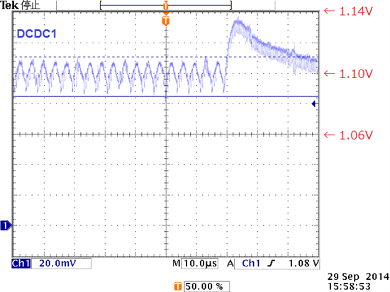

    The customer checked a ripple and a load transient phenomenon in power save mode. The DCDC1 output does not seem to be beyond the +/-4% recommended voltage range of AM335x.

    When the DCDC1 output voltage is increased to 1.110V, all failed boards seem to work correctly.
    Our customer is investigating when the DCDC1 voltage drops below the recommended minimum voltage.
    Daisuke
  • It looks like it is on the insertion of a current transient that causes a voltage droop. Can you take a scope shot of the transient with a zoom in on the voltage droop? (ILoad goes from low to high)

    Our customer cannot confirm that a voltage drops below the recommended minimum voltage. They are going to be supported by our local TI.
