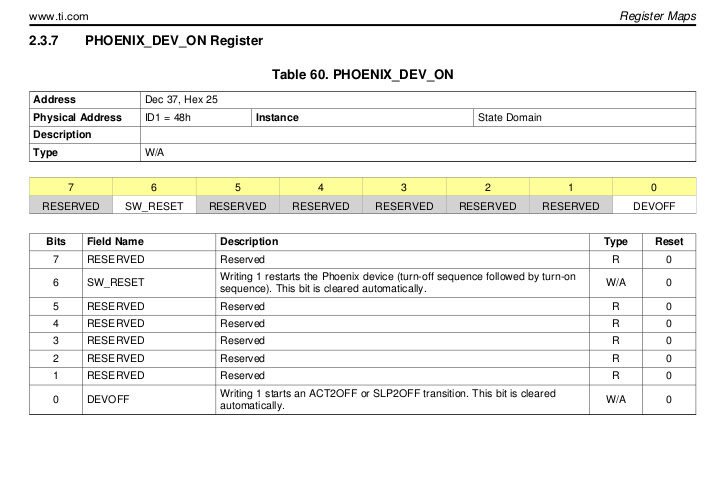

Hi All,
Our project requires integrating OMAP4460 with PMIC TWL6032 .
Problem :
Writing at u-boot to the following register.
Slave address :0x48h Register address:0x25 Value :0x1.  reboots the system
Expected result:
PMIC has to shutdown
Actual Result:
System reboots.
Could anyone help in resolving this issue ,since this command works on the reference board.
