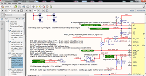

To attempt to test this device prior to using it on a much larger design, I made a PCB with the reference design on the Beagle Bone Black board (minus the AM335x processor) and tried to test the IC. Upon powering on, the SYS_5V oscillates between 3.11 and 4.0 V, the current draw ranges from 1 mA to occasional spurts at 12 mA and the LDO1 rail oscillates between 0V 0.33V and 0.65V. I'm not really sure what to make of this. It seems that the only input that the power-up is reliant on the is the PMIC_POWER_EN, so it seems like tying it high would cause the system to power up.

  • So the main difference between this diagram and the test board is that the PMIC_PGOOD, LDO_PGOOD, WAKEUP, and PMIC_INT outputs do not go to a processor and are instead test points. Also, the PMIC_PWR_EN does not go to the AM335x, but is pulled high to the SYS_5V rail. I have measured this input and it tracks the SYS_5V as it should. The issue is that the SYS_5V output is not stable and varies from 3 to 4V, an issue I cannot make sense of. The I2C lines are not connected either. It seems that according to your input the device should power up as long as PWR_EN is pulled high. Please let me know if the attachments that I provided are too difficult to read.

    Where is the 2.2uF output cap on VLDO1 (pin 3)?
    Janice
  • In the top screenshot that I sent you (showing the lower right portion of the schematic block), it is connected to VRTC. However, since I had limited space, it is off to the right side where the 3 parallel green boxes show VRTC, VDDS, and VDD_3V3AUX. It is capacitor C208.
  • Tony,
    This could be due to a layout issue, like the caps not being close enough to stabilize the LDO, but that's hard for me to tell? Are you getting any faults, like PGOOD going low? Have you looked at our EVM for this part, would you like me to send you one so you can evaluate the part?
  • PGOOD never goes high, which I would expect due to LDO1 never going high, which indicates a fault. It would be great to evaluate the part with the EVM. The layout for this board could potentially be an issue. It is much more tightly arranged in the actual design than this test board, so we could be running into issues there. I can try to add capacitance closer to the IC in the meantime to see if this stabilizes anything.
