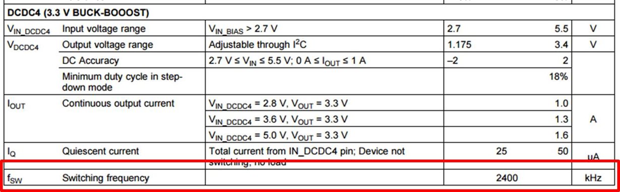

Hello Team,
I'd like to ask you about SW frequency for TPS65218.
Could you tell me the SW frequency of DCDC1 to 3?
I think the SW frequency of DCDC1 to 3 is also 2400kHz.
Is my understanding correct?

Matsunami-san,
DCDC1-3 use TI's DCS control topology and do not operate at a fixed frequency. Typically the frequency is around 2MHz, but can be as high as 3.6MHz.
