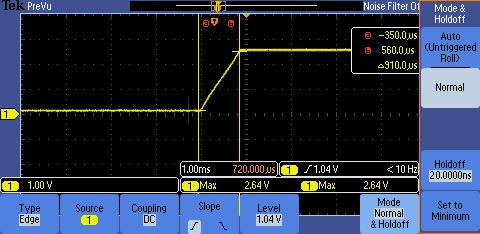

    Can you please post waveforms with the LDO_ENs, VIN ramp up, and the LDO outputs? If the device is allowed to have its VIN ramp up to 3.9V then have the LDOs enabled the start up time is shorter than if the LDOs are always enabled and the LDOs turn on once the device exits UVLO. In this latter case, the LDO start up times can be longer. See images below for example:

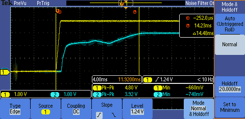

    Pls find attached waveforms FYR.

    Please find attached file for the  Power sequencing we are following in our design .
    I am observing the 3.3V and 3V waveforms during power up on Oscilloscope . The observed waveform attached ( Blue: 3V and Yellow:3.3V)
    I have observed  3V stabilized earlier compared to 3.3V .But reverse shall happen as per our design.

  • It looks like the VIN would be ramping when the 3.3V is trying to start up. Can you add a delay to the 3.3V LDO or the first DCDC to wait for the VIN to ramp up to nominal voltage before you enable the rails. You can add RC delays to the ENs to pace of the rail sequence.
