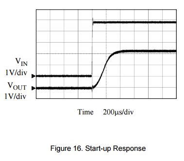

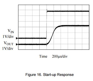

  • Some more details on the 3.3V Regulator - It has a roughly 400us startup delay from input to output.  That means the CC pin is getting 3.3V about 400us after IN_BU, IN_LDO1, IN_DCDC1, IN_DCDC2, IN_DCDC3, IN_DCDC4, and IN_BIAS are getting the system power from the battery charger.  Is this delay significant enough to cause problems?
    I also wanted to let you know that we did check the FSEAL bit and it is still not being set to 1.  Do we have to set FSEAL = 1 manually (by writing to the password register) for every single PMIC chip we receive from the factory?
  • Hi Trent,
    Yes the FSEAL bit needs to be written each time by the SoC or I2C master to set the FSEAL bit to 1. Below are some more details on how the FSEAL bit works. When your main supply and CC power are both lost the FSEAL bit will be reset to 0. Let me know if you have any questions. Thanks!
    Paul Kundmueller
  • Hey Paul,
    Ah I see, I was under the false assumption that by following your How to set FSEAL = 1 without a coin cell instructions from your first response that we wouldn't need to do any I2C writes.   I cannot view the details image you included in your latest post.  If I have any follow-up questions I will post them here.  Thanks for your assistance.
