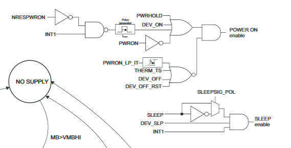

For the power-on disable (ACTIVE-to-OFF state transition), there are three kinds of conditions.

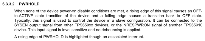

PWRHOLD is not related to these conditions. It seems to mean that the power-on disable is not controlled by PWRHOLD.
On the other hand, PWRHOLD is described that a falling edge of this signal causes a transition back to OFF state.
I want to make it clear whether the power-on disable can be controlled by PWRHOLD.
