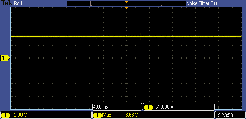

    2. I see the Minimum differential output swing appears to be 3.6V, are you saying you need 3.2V instead? And that the VPP is the same from VIBRA_SET = 0xFF vs. VIBRA_SET = 0x01? If so, can you post scope shots of both differential (VIBRA.P relative to VIBRA.N) and single ended (VIBRA.P relative to GND and VIBRA.N relative to GND) for both VIBRA_SET conditions? This will allows us to ensure that the circuit isn't bottoming out.

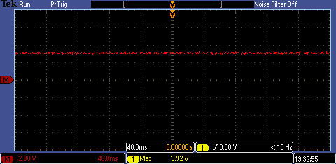

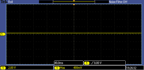

    Yes, we need 3.2V instead of the default minimum 3.6V and we are not seeing the change in VPP for VIBRA_SET = 0xFF vs. VIBRA_SET = 0x01.
    Here are the snapshots of the vibrator pins:
    VIBRA_P_VIBRA_SET = 0xFF
    VIBRA_N_VIBRA_SET = 0xFF
    DIFF_VIBRA_SET = 0xFF
    VIBRA_P_VIBRA_SET = 0x01
    VIBRA_N_VIBRA_SET = 0x01
    DIFF_VIBRA_SET = 0x01

    What Vin are you using? Note that due to it being a simple driver in this configuration, the Vin will always pass to the Vout when the high side is on; we are just modulating the voltage to get a set current value. If you need a lower voltage, you could potentially try a resistor in series if you know your current?
    That said, I would expect the VIBRAP to be oscillating with the internal PWM signal. VIBRAN should be short to GND with your configuration.
    What value do you have in the VIBRATOR_CFG register? If VIB_PWM = 0, then that might explain why there is no PWM. Also, PMBR1 needs to be set so that GPIO7 is in the appropriate mode (as GPIO7 or as VIBRASYNC if you are using VIBRASYNC). Also, LEDA and LEDB need to be disabled.

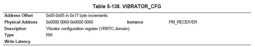

    We are not able to understand the address offset specified in the VIBRATOR_CFG register. It is mentioned as 0x05-0x05 in 0x17 bytes increments. How do we interpret this address offset?

    For the I2C, I believe you can ignore the physical address and increment and just focus on the 0x05 = register address. Looking VIBRATOR_CFG up in the I2C address tables (Table 2-6) shows it listed under device I2C address 0x4B. Those two should be enough to bit bang that particular register, let me know if it works or not.

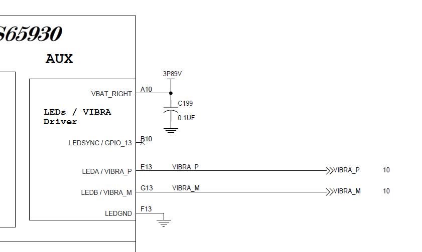

    The vibrator connection in our design is as shown in the image below:

  • Hi Naveen,
    The order should be same as 10.5.1 Vibrator H-Bridge in the TRM, though of course modified to your application:
    1. Disable LEDA: Set the LEDEN[0] LEDAON bit to logic 0.
    2. Disable LEDB: Set the LEDEN[1] LEDBON bit to logic 0.
    3. Turn on the codec: Set the CODEC_MODE[1] CODECPDZ bit to 1.
    4. Set VIBRA_SET to desired (0x0F for example)
    5. Set VIBRA_CTL to 0x01
    One additional thing you can check is if setting VIBRA_CTL[1]VIBRA_DIR to 1, do you see the VIBRA_P short to GND and VIBRA_M voltage go to 3.7V? This would allow us to at least confirm that the I2C writes are working as expected.
