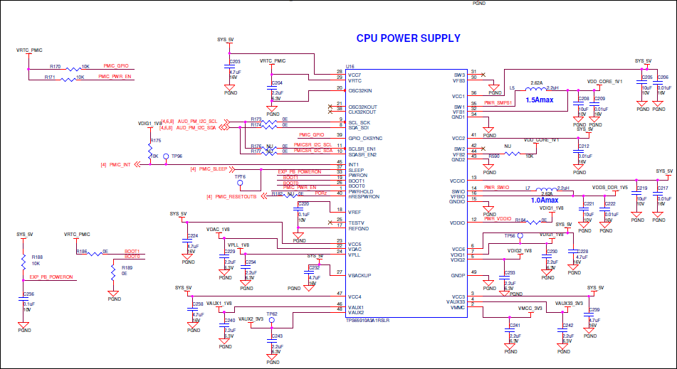

One of my cusomer is working on consumer product where they are using TPS65910 PMIC for AM3351.
They are facing issue with radiation from TPS65910. Theyhave kept the provision for snubber, but not able to tune as per requirement. On spectrum we are able to see continous 3 MHz peaks till 100MHz at every 3MHz spacing, so it is confirm that noise is from power supply only.
Unit is exceeding the limits by some 5dB when went for the average scanning. In Quasi mode they were able to pass the unit in radiation also. To be safe we are trying to bring down the radaition by 10dB so unit can pass with enough margins.
Any suggestion from you guys will helps us to close the issue. Kindly help.
