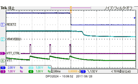

    Q1:the status of VR4(VDDQ) rail when this fault happens.
    -> VR4(VDDQ) rail is high (normaly status).
    Q2:a scope shot of the VTT rail
    ->Please see the blow picture.
    Q3:Does it start and then shutdown after some delay or it never turns on?
    ->It never turns on.
    Q4:please confirm what is status of SLP_SUS#, SLP_S3,SLP_S4 and SLP_S0 and VCCST_PWRGD signal.
    Shimizu
  • Shimizu san,
    in the plots above, I see that multiple pulses of VTT_CTR signal for only few <200us. Can you confirm if this is expected. I see fault happeing only after 3rd pulse. what is the value of status registers 0x16 and 0x17 after the fault.
    ->VTT_CTR signal is controlled by OS.
     Must we operate VTT_CTR signal to under 200us?
    >I see fault happening only after 3rd pulse.
    ->The pulse of VTT_CTR is generated many times.
       The fault happening not only after 3rd pulse.
    ->0x16=01h
       0x17=00h
    Shimizu
  • Shimizu,
    As VTT rail is switching on and off fast, this would cause the feedback node noise and create a fault. Our recommendation is to always mask VTT_FLT_Mask=1.
