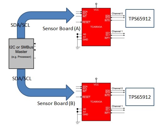

  • Hi Kevin:
    Thanks! I've received the update block function from customer (as attached). (use 2 TCA9543A for 2 PCB)
    would like to check with you whether it's workable or not
    and any of their A0/A1 set-up config need to be noticed?
  • Hi Kay,
    I think you should only need one TCA9543A near the master (or at a junction point between the two sensor boards), though two would work as well.
    I have no expertise with the TCA9543A, but looking at the datasheet I would suspect that if you are using two of them then you would need to set the A0/A1 of them differently or else you will have the same I2C address conflict problem you had with the TPS65912s. This could be avoided by just using one TCA9543A though and connecting one TPS65912 to channel 0 and one to channel 1.
