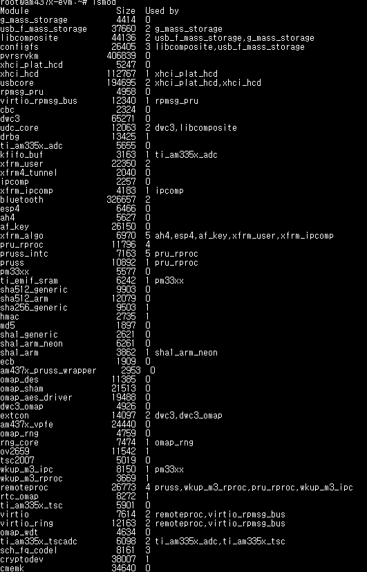

Do I have to write something through i2c?

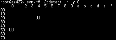

However, the 0x24 address is UU (used).
Which driver is the TPS65218 driver?
if there is a driver, what should I do ??

    What does PMIC register dump mean?
    And how can i get the PMIC register dump?
    TPS65218 i2c address is 0x24
    That is busy..
