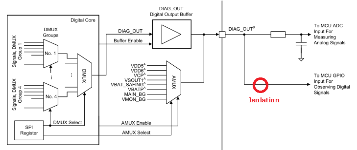

When using diag_out as both adc and gpio, it is written in the data sheet as shown below.
If the application must measure analog signals with an MCU ADC and monitor digital signals with an MCU GPIO, the
application design must assure the GPIO input stage does not affect the ADC measurements. If isolating the MCU
GPIO is not possible within the MCU, the application design must achieve the necessary isolation externally.(datasheet:34page)
When both are used, although it is written that GPIO is isolated, is there no problem if using an inductor?
Also please tell us the AD and recommended R and C constants.

    The word isolate may not be the best choice of description about this topic.  What was intended with this statement is that some MCU IOs have integrated pull up or pull down resistors or they have high leakage that would cause any analog output via AMUX to be in accurate because of the influence from the GPIO on the signal.  If the MCU used has a GPIO pin that can be high impedance and thus have no impact to any analog signal output via AMUX then it is fine.  I'm not sure an inductor would work because since at DC it would still allow the current to flow into the MCU if the MCU GPIO pin was not high impedance.  Normally in a case where the MCU is not high impedance a buffer with high input impedance could be used between the DIAG_OUT pin and the GPIO.
    In most cases I have seen the MCU GPIO has a programmable or configurable pull up / down and high impedance option, so usually the GPIO can be correctly configured on the MCU itself.

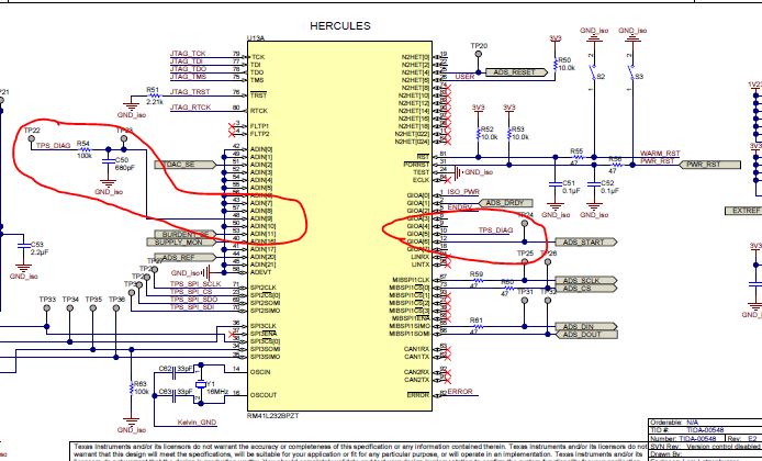

    Place the buffer between DIAG_OUT using the pull-down GPIO pin.
    There is a low pass filter in front of the ADC pin, is it necessary?
    (MCU uses RM46L852PGE.)

    If the MCU IO pin cannot be put into a high impedance state then the bugger needs to be between the DIAG_OUT and the GPIO pin.  Whether or not a low pass filter is needed depends on the specific MCU and the ADC of the MCU, or other ADC that is connected.  We have a TID-Design, that uses a similar MCU, the RM41L232.  Below is the schematic capture for this TI Design and how the TPS65381A-Q1 DIAG_OUT is connected to the RM41 MCU.  The net going to TPS DIAG_OUT pin is called TPS_DIAG and is seen below.  This net goes directly to a GPIO that can be put into high impedance mode and then is connected into the low pass filter and the ADC channel.  The full design files and information of this TI Design are available at:  http://www.ti.com/tool/TIDA-00548
