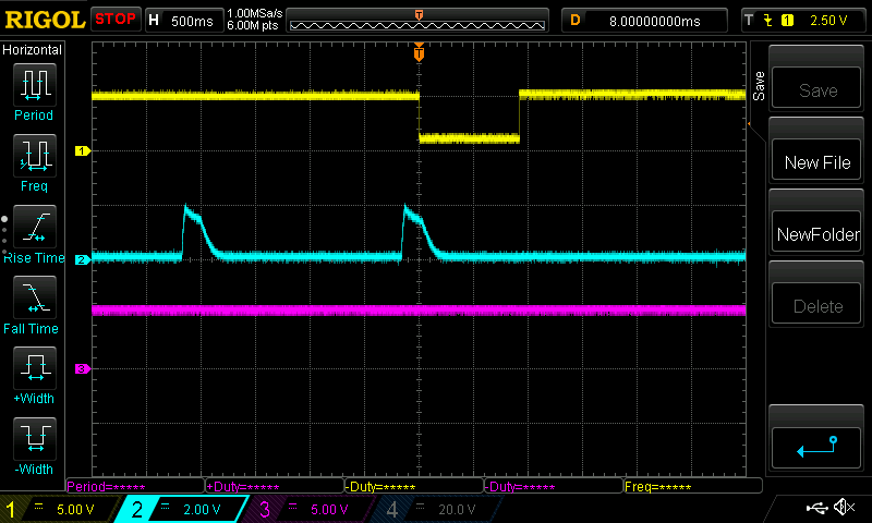

Instrumenting a board I was able to capture several instances of the following:
Channel 1 is the SYS_5V out of the PMIC
Channel 2 is USB input to PMIC
Channel 3 is AC input to PMIC
This was done with USB disconnected from the board, and powered via a bench supply at 14V feeding out 5V switcher.

    the PB_IN is connected to a button, which I know that is not being pressed.
    I was capturing PWR_EN on some of my instrumented tests, along with the battery terminal.  PWR_ER was falling about 260 us after SYS_5V.
    I know BAT_SENSE is not connected to BAT, I will make that connection and retest.  We may need to run with this configuration until we have a slot to rev the PCB if this is the issue.  I will setup the test and report back.

  • Matt,
    It is clear to me there is a spike on BAT when you zoom in on the timing between SYS & PWR_EN.
    It is unclear to me if there is a spike on BAT every time the USB power glitches or if there is only a spike when SYS drops.
    Can you zoom in on an area where USB is falling from it's peak value and SYS does not drop, so that I can see the BAT pin voltage?
