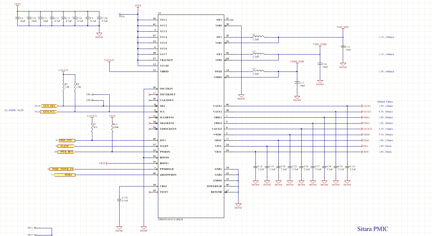

We are using the AM3358 (Z1) with the TPS65910A31A1 PMIC spec’d in. Our CM substituted TPS65910A3A1 parts.The datasheet doesn’t state the differences. Can you describe if they can be substitutes?
Also, we are experiencing a series of failures where the AM3358 seems to lock up and a PMIC reset (long power button press) doesn’t reset the micro.
I have looked at two of our assembled units which are exhibiting this problem. In both the PMIC is producing VDD_MPU = 1.1, VDD_CORE = 1.1, VDDS_DDR = 0.
If we completely remove power the PMIC will be reset and the units will reboot.
This problem state is spurious and difficult to repeat. Getting the same unit to repeat the failure mode hasn’t worked reliably.
Please ask your factory if they have ever encountered this problem and if the substitute PMIC could be the problem. If it isn’t the problem, see if they have any ideas. We are scheduled to launch the product next week, but this could be a show stopper.

    The difference between the two is the VRTC regulator mode in the OFF state. The A3A1 has the VRTC in low-power mode in OFF to minimze quiescent current, but it cannot support more than 100 uA of current in this mode. If current draw is higher than this in OFF state, the VRTC will crash (or fail to reach 1.8V) and the part won't function properly since VRTC powers the internal digital.
    In the ON state, the two should be the same.
    I have not seen VDDS_DDR issues before. I have seen cases where there were too many pull-downs on the VRTC rail and so the A3A1 was failing where the A31A1 would successfully boot, but this sounds like it is not a boot problem.
    Not connecting pins 10 and 11 will result in voltage scaling not working unless the SR_CTL_I2C_SEL bit is changed to 1b.
    For the long power button press, what does the INT signal do? A long key press should shut the PMIC down unless the processor is clearing the INT (datasheet pg 49).
  • A follow up: are you able to hack into the I2C lines to talk to the PMIC with an external controller, like USB2ANY? I'm curious if the VDDS__DDR rail is possibly being disabled or set to 0V accidentaly by the processor. We could read the registers and see what writes the PMIC has received.

    Customer based their design on TMDSSK3358 for the original layout with the TPS 65910A3 as the PMIC. It did not use the Smartreflex pins. See page 5 if the attached reference schematic.  I confirmed that thy were not needed with Rebel. Ultimately to properly implement the low power modes, we moved to the A31A1 version around January 2016. The design when using the A31A1 part has been working fine since then.
    We are going to attempt to hack the board (while it is still powered) to see if we can control the i2c bus. If we disconnect the power the problem state is gone and no longer observable.

  • We looked at PMIC register dump from working unit.  The sleep registers look OK but we can't be sure of the values after the lock up.
    Attached is the register dump.

    is ILMAX is 0 on VIO_REG, VDD1_REG and VDD2_REG, so we need to correct those.  For example schematic shows SWIO 1000mA but we have PMIC set at maximum load current of 500mA.
  • Hi Aaron / Brian,
    Thank you for checking with the TPS65910A31 and confirming the issue can still be reproduced, that means no need to focus on VRTC.
    Let me know the results of the ILMAX test. If drawing 1A with minimum ILMAX, then the part could detect a short circuit and shut the rail down until rebooted which sounds consistent with the identified failure.
    An alternate test for the same goal would be to try to disconnect VIO from the load and power the load externally and see if the failure still occurs.
  • They tested setting ILMAX to 01 (1.0A) in VIO_REG, that did not fix the issue but a workaround was found to prevent it.
    The PMIC register dump shows some register values that look like writes intended for another device on the I2C bus. Some code changes were made to prevent multiple threads from trying to access the bus simultaneously. They have not seen the issue in any testing since making that change.
