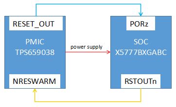

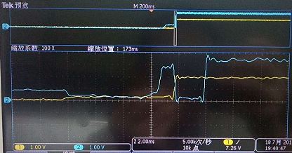

  • Ok, we have adjusted the BOOT0 configuration of the TPS659038, but the RSTOUTN pin of the SOC also seems to have a similar exception output.
    Are these two related? Is the SOC terminal output RSTOUTN signal normal?
    TPS659038 PIN_G6(RESET_OUT signal:yellow line) VS  TDA2(DRA74*)  PIN_F23(RSTOUTN signal: blue line)  as follow :

    I made a connection between SOC and PMIC, as shown below:
    SOC part number: X5777BXGABC
    PMIC part number: O9039A387IZWSRQ1
    The cause of the problem is that the RSTOUTn waveform of the SOC power-on output is abnormal, and the RESET_OUT output of the PMIC is measured to have a similar abnormal waveform.
    As the above reply, we have adjusted the RESET_OUT output of the PMIC (blue waveform in the figure) through the BOOT configuration, but the RSTOUTn waveform of the SOC power-on output is still abnormal (yellow waveform in the figure).
    So, now we have to continue to investigate the cause of the RSTOUTn waveform anomaly.
    Please check the processor data manual for the relationship between PORz and RSTOUTn. I am not clear on what is abnormal here.
    Nastasha
