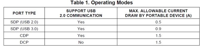

    Your question is whether you can have CDP mode charging current increase from 980mA-1.5A, am I right?
    CDP mode, BC1.2 requirement: Host side must be 1.5A min ability, devices side 1.5A max (can't pull over 1.5A)
    It really depends on device side how much current they need under CDP. As your test result is 980mA+ data, which means the CDP handshakeing with device and CDP host has successfully finished, as charging current is >500mA (SDP). But it's device's choice to charge 980mA not to 1.5A. TPS2546 has done CDP handshake with it, it's the device side decide how much current they need.
    Examples:
    iPhone5/5S supports CDP fast charge, they charge 1A under CDP, already higher than 500mA, but they don't go up to 1.5A.
    iPad4/Air can also support CDP fast charge, they charge 1.4A, close to 1.5A under CDP.
