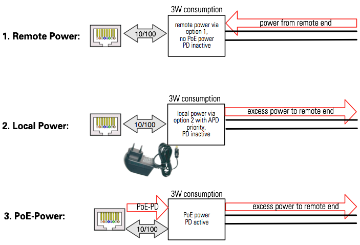

I have a special application, where I want to provide local power, e.g. via option 1, for cases when there is no PoE power available. Conversely, if there is PoE power available, we would like to transfer part of that power over the same local power pair to a remote location, i.e. reverse power flow. Has any body done this?

  • Hi Darwin,
    yes, here is a block diagram. There are 3 operation cases, depending on the power source. I am having no problem sinking the power. But how would I source power to the remote end in the last 2 cases?
    Case 1 is straight forward, using power option 1 from the report. A bridge rectifier ensures correct polarity.
    Case 2 is also clear from the power source, using an adapter with option 2; adapter preference using the APD pin function.
    Case 2 and case 3 should also deliver power to the remote end, i.e. sourcing, and "going around" the bridge rectifier used for case 1.
    Any ideas are appreciated, Michael
  • Hi Michael,
    Option 1 would not be an appropriate option for this application seeing as the remote power line can also sink current. When the PoE power is connected, the remote load will prevent the PoE side from detecting and classifying. The remote power/load would have to be after the PD such as on option 2.
    Will the remote end 'know' when PoE or adapter is inputted and 'know' to switch from sourcing to sinking current? Then you can simply directly connect the remote end after the PD.
    This is not an application I've seen before.
  • Hi Darwin,
    understood. We would need a circuit, which would signal the presence of PoE power or adapter power and only then connect the remote line via a MOSFET, for example.
    No, the remote end does not know anything about the local end. It will see the remote input as adapter power, when not supplied otherwise. Both units, local and remote, are identical.
