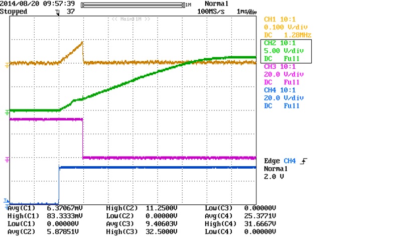

    Operation with the system was checked about the timing of Vds and a Vgs comparator of operation.
    As a result, in order that a Vds comparator may work previously, it does not become as the normal standup sequence which has a statement in a datasheet. (see a figure)
    - May I judge that it is normal as operation?
    - When an order changes, aren't we anxious about some?
    - If the above-mentioned operation is judgment of being normal, what kind of state is the sequence of the figure the motion supposing?
    Please let me know about the three above-mentioned points.

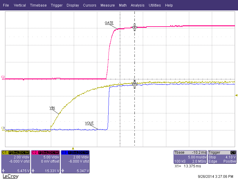

    2.What I care about most is the gate voltage at the time of power supply starting.
    I want gate voltage to be over 10V in the hit which the power supply rose and exceeded the threshold value in the 5V neighborhood.

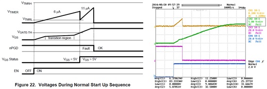

    3) The waveform is measured by direction of the usual NMOS Q1 and Q2 like a figure34 of datasheet.
      Although it is what this waveform is normal, figure24 of a datasheet differs from a sequence.
    Is what differ assumed?

    3) Sorry, my last explanation was wrong.
      A right waveform is a recommended circuit as shown in Fig. 34, and it expects and acquires a waveform as shown in Fig. 22.
      However, operation is different if Fig. 22 is compared with an actual waveform.
         Specifically, it seems that there is no fault period.
         What is assumed as for the cause of this difference?
      ch1:Vtimer    ch2:Vgs  ch3:nPGN  ch4:EN
  • Hi Yoshida-san,
    For 2) I will test this in the lab on an EVM and provide the results.
    3) I am having trouble analyzing the waveform, but first I would not recommend using the back to back FETs in this way. The reason is that the FETs no longer have their source pins tied together, and therefore Vgs is not equal and controlled. For example, you can easily apply reverse voltage to Vgs and cause damage to a MOSFET.

  • Hi Yoshida-san
    2) I went in the lab and measured the gate voltage on an LM5060 where UVLO was disabled (tied to VIN).
    As you can see from the attached waveform, when VIN reaches ~5.475V, the Gate voltage already reached 15.331V (when measured with a multimeter after stablized, with VIN = 5.573V, VGATE = 15.745V)
