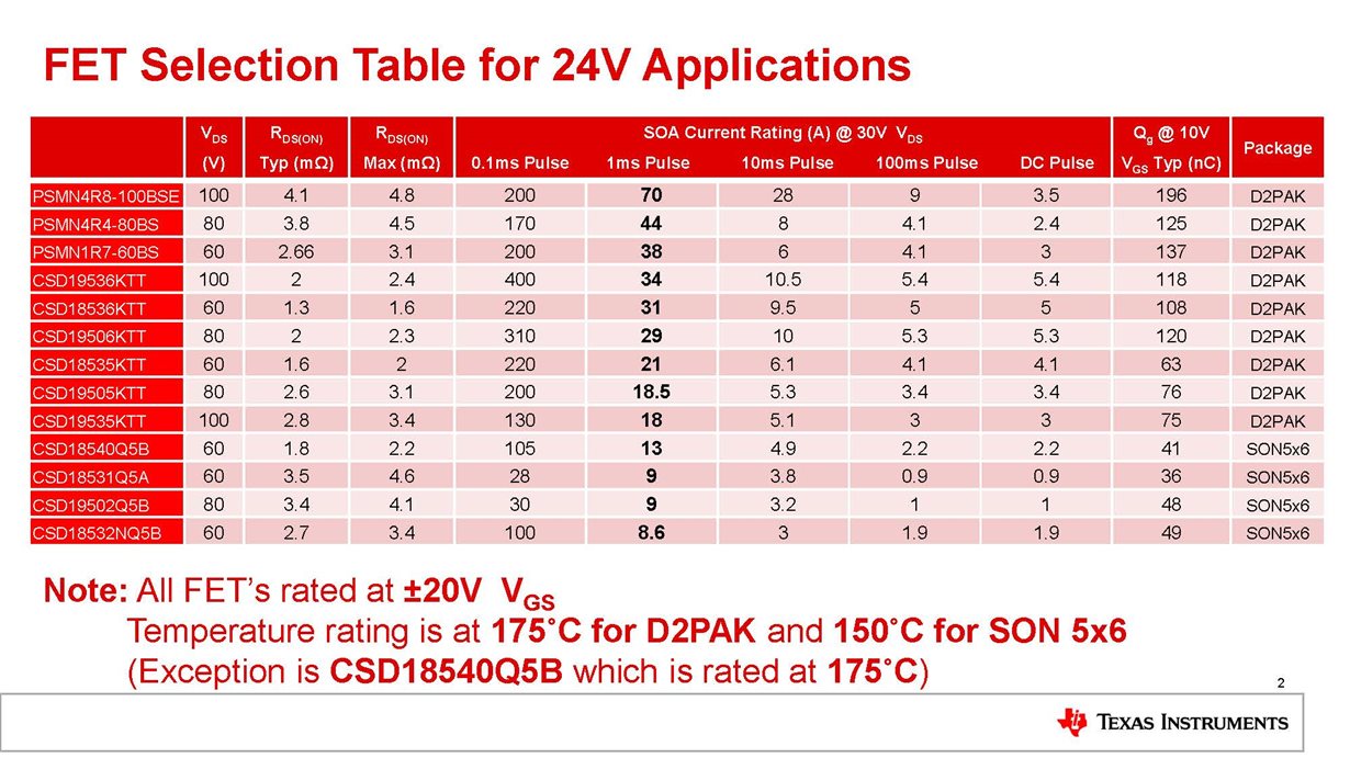

    Also as an update since this thread, our company has released a couple of new 100V FETs with strong SOA for hot swap applications.
    For very high power, the CSD19536KTT is one of the best we've seen when it comes to low Rds-on + high SOA performance, in a surface mount D2PAK.
    For lower power applications, the CSD19532Q5B is a strong choice as well with low Rds-on, decent SOA packing a 5x6 QFN.
    We made a slide to help illustrate our MOSFET portfolio specifically around SOA rating and Rds-on since those are the key careabouts for hot swap applications.
    Overall, SOA is a thermal property and often is correlated to the die size. Obtaining low Rds-on and high SOA means a large die area stuffed into the package.
