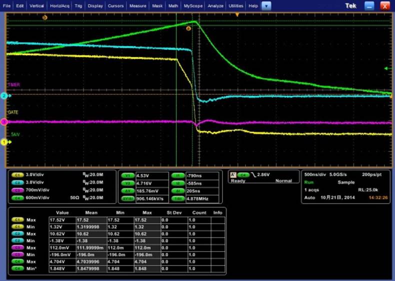

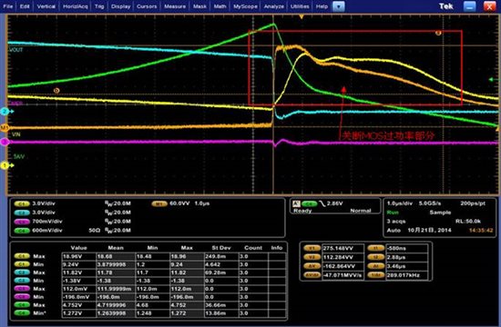

I have one question about LM25066 as below.
When output is short, is power limit effective here? Please see below waveform of output short test.
CH1:VIN  CH2:VOUT  CH3:TIMER  CH4: Iout(5A/V)   M1: MOS Power (Vds*I)
Power Limit set: 111W
Current Breaker set: ~23A
From waveform, after output is short, maximum MOSFET power is >111W, and maximum current is just ~23A.
Thanks.
Johnny

  • Alex,
    From scope curve measurement, the maximum power of M1 is ~275W. C4 "zero" line is the same position with C1. CH4: Iout(5A/V)
    From device design feature, will power limit be effective when this kind of output short happens?
    Thanks.
    Johnny
  • I see it now, thanks Johnny.
    So the device is not going into power limit in this waveform. What you are seeing is that M1 is not showing the power through the FET, but rather the energy which is going into the TVS and being clamped.
    The input current to the right of Vout = 0 is nearly all into the TVS, and Vin being held nearly constant at 18.5V (with minor LC ringing) is the clamped voltage for that current.
    If the device is setup for retry, then later in the waveform you will see the device try to power back on, and at that point, it should be hitting power limit if the load is still shorted and you would see the timer pin begin to activate (and then fault out) when that occurs.
    Alex

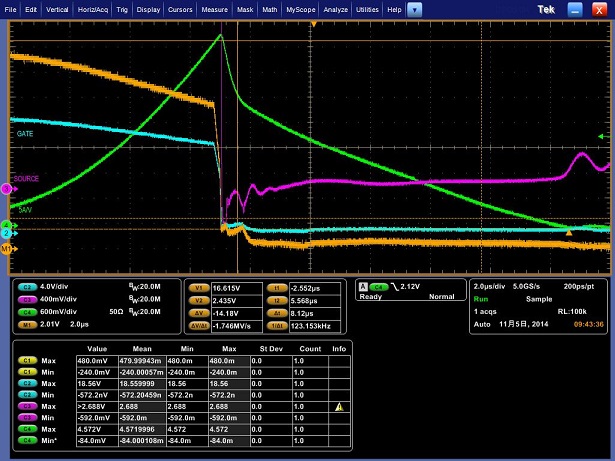

    In below waveform, CH1:GATE   CH2:VOUT, all voltage is test on EVM's test point.
    It seems the (GATE-VOUT) voltage has dropped to zero. For parasitic parameter influence, do you mean it's better to probe VIN and VOUT voltage directly at drain and source side of external MOSFET?
    Thanks.
    Johnny

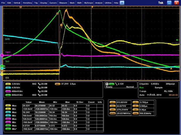

  • Alex,
    Below is latest test waveform from customer.
    CH1VDS  CH2GATE    CH3TIMER   CH4:IOUT, 5A/V    M1:CH1*CH4*5(5A/V)
    VDS is test with differential probe. GATE is test at MOSFET side. IOUT is test at load side.
    From waveform, the maximum value of M1 is 313W. The maximum value of CH1 is ~20.5V, and CH4 is (4.57*5=22.8A).
    Below is the GATE-VOUT waveform.
    CH2:GATE   CH3:SOURCE  CH4:IOUT    M1:CH2-CH3 (GATE-to-SOURCE voltage)
    GATE and SOURCE voltage is test at MOSFET side.
    From above waveform, when VOUT drops to zero, GATE-SOURCE is 0.4~0.5V for 1us.
    From all test result, we come to a conclusion that when VOUT is shorted, GATE sink current is 190mA and power limit is not effective.
    Please give your suggestion and comments here.
    Thanks.
    Johnny

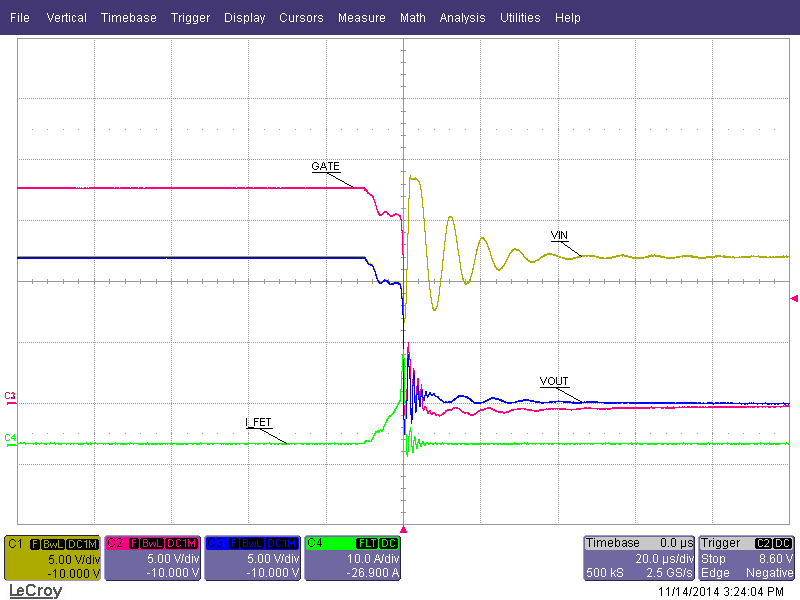

  • Hi Johnny,
    So depending on your e-load and setup (such as slew rate programming or using the "short" function versus a physical short), you may see slightly different results.
    This tests shows the current from IIN. This gives an accurate representation of the current through the FET until the gate turns off. At this point, no current will pass through the FET, and the current shown after this point is simply energy which is being absorbed by the input TVS.
    This waveform shows the output load which is regulating the current to 1A. In terms of wires/location, the short was applied just before the E-Load connection.
    This last waveform was taken and shows the current going through the wire which is being used to short circuit.
    As you can see, there is a large amount of current which is continues to decrease after the gate pulls low. This current is the energy being discharged from the output capacitors.
    In order to show the true power across the FET during a circuit breaker, you would need to remove the output capacitors from the EVM and apply a short.
    Alex

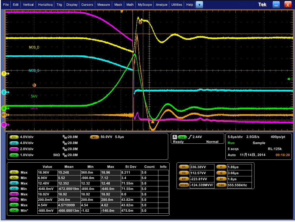

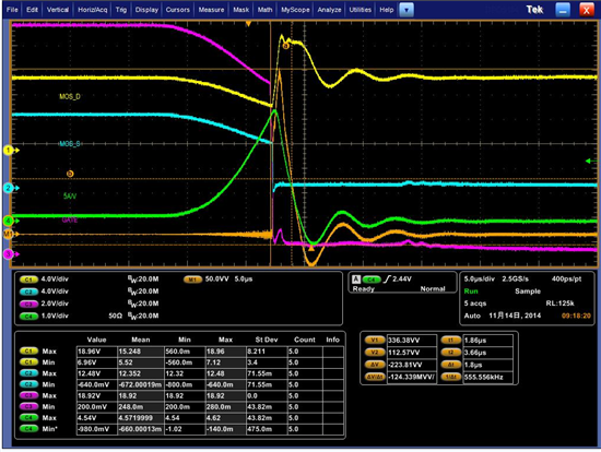

  • Alex,

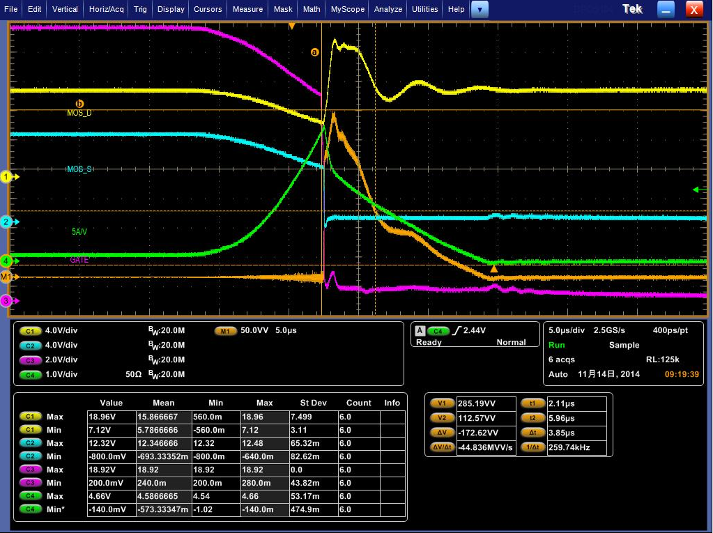

    Some update from customer.
    They removed all input and output caps on board. Below is waveforms with IIN and IOUT.
    Power limit is set at 111W. From IIN waveform, the time of (FET power>111W) is 1.8us. From IOUT waveform, the time of (FET power>111W) is 3.85us.
    I have discussed this with customer. Since the circuit breaker sink current is 190mA, if MOS_S voltage drops too fast such as in short circuit situation, the FET shut down speed is not fast enough to limit FET power due to limited sink current 190mA.
    Also for other competitors' devices, FET power is not limited when output is short.
    Please give your suggestion here. Thanks.
    CH1: MOS_D  CH2: MOS_S  CH3: GATE  CH4: IIN (5A/V)  M1: FET POWER, (CH1-CH2)*CH4*5A/V
    CH1: MOS_D  CH2: MOS_S  CH3: GATE  CH4: IOUT( 5A/V)  M1: FET POWER, (CH1-CH2)*CH4*5A/V
  • Hi Johnny,

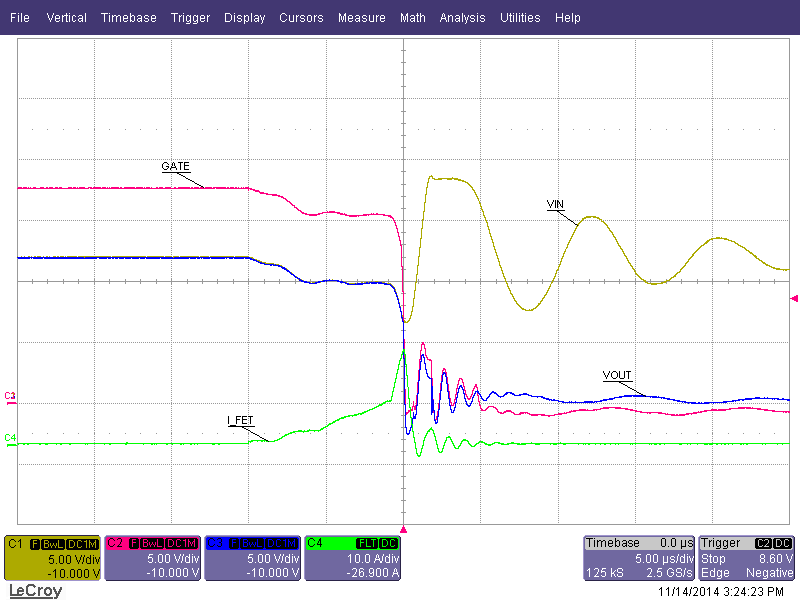

    Below is a circuit analysis diagram before and after a hot short:
    As you can see, there is slight inductance in the traces and/or the wire used to make the hot short. Because of this, the current in the inductor cannot change immediately. Instead it will follow the equation V = L di/dt, so effectively the current will decrease as a function of V/L. For the load side of the hot swap controller, V would be the negative voltage of the Shottky, roughly -1V. You can calculate L by using the negative slope of di/dt in the waveform.
    Thus in the test I conducted, I moved the output schottky diode from the bottom of the EVM to the output capacitors. This leaves the IC potentially open to damage since the schottky is far from the IC, but it was done to illustrate that there is little to no current between the FET and the output capacitors after the GATE voltage is at GND (shown in my previous waveforms). Note that if you remove the schottky completely, it will likely damage the IC since the current needs to be pulled up from ground and will have nothing to clamp it for protection.
    So to answer the question, the current shown in the customer's waveforms above are either going into the input TVS (if looking at the IIN waveform) or into the output schottky diode (if looking at the IOUT waveform). The device is not power limiting simply because there is no current through the FET once the GATE pin goes to GND. The device will try to start up and will immediately go into power limit shortly after the circuit breaker, but it is not shown in the waveform above due to the timescale. If zoomed out, the behavior will look similar to Figure 5 in this application note:
    http://www.ti.com/lit/an/slva673/slva673.pdf

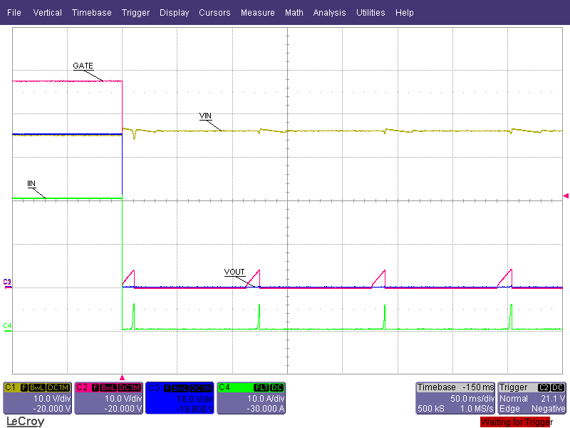

    For reference, here is a short circuit waveform of another device which shows the behavior. The device is connected to a 30A load, and then has a short circuit on the output. This causes circuit breaker to trip and the devices shuts off the gate, then retries into power limit, times out and then retries periodically):
    Alex
