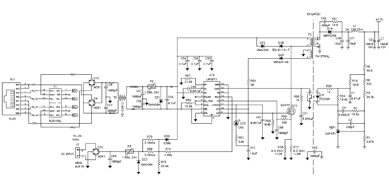

We have a circuit built using the LM5072 that uses the RAUX input for external power to our device.  The circuit doesn't output anything (doesn't appear to turn on) until about 14.2 volts on the input.   This seems to agree with the data sheet that describes the regulator turn-on voltage of 14.5 volts.
SO HOW is thing spec'd to operate down to 9V input?   My circuit will continue to operate down to 9VDC, but only after it's been turned on with a voltage above 14.5V.  There must be something I'm missing.
I need to be able to put 9V into this thing and have it produce 12V out, and start up properly.   What do I need to look at, change, etc.??

    Is the 9V powering the between VCC and RTN? Also, is the RAUX voltage higher than the rising threshold of 3V? Can you send a schematic of your PD design? Thanks!
  • No, 9V is on the Vin input, referenced to GND (RTN).  I'll try to send this portion of schematic.  RAUX voltage is 9V or higher.

    What is the voltage on VCC? It must be 8-15V. Notice on page 19 of the datasheet regarding low input voltages. You will need supply the VCC directly from the Aux voltage via diode ORing.

  • OK Darwin, I got the circuit to start up by using the diode-or.   So I can use the Raux input down to 9V or so.   BUT then I went to test the high side by cranking the RAUX input up to 30+ volts, and I blew the diode that was being used to connect the aux input to Vcc.   Is the diode or'ing supposed to work at all voltages?
    The diode I used was only a 200mA forward current diode.   I could use a higher-current version, but is this advisable?  How much current is drawn on Vcc typically?

    The abs max rating on the VCC pin is 16V, since it is ORing with the bias winding, the 30W is being seen at this pin. Typically, the adapter voltage is a set voltage (ex 12V wall wart) where it won't exceed the abs max rating.
    At higher adapter voltages, if you need to switch to the bias winding voltage, you will need some kind of logic switch to not allow the high adapter voltage get to VCC.
    Or you can add an LDO with a wide input range to power the VCC pin from the adapter. The current is only 3mA max at 10V.

    Thanks for checking in!  YES, I was able to get the circuit working completely.  I needed to eliminate the diode bridge on the input because we are getting too much voltage drop across it.  So we will go with dedicated + and - inputs for DC, with some other protection method.
    To simulate the LDO without needing to build up an actual circuit, I just used a bench power supply to input a fixed voltage to Vcc through a diode.  I'm setting the supply to 8.5 volts or so.  Works in all conditions.  We're going to spec our DC input as 12 to 24 VDC - it will work down to 9 to accommodate droop or voltage drop, and up to 27+ to accommodate a 24V supply that's 10% high.
    The LDO I plan on using is a Linear Tech LT3011 (sorry), unless TI has a similar one that's cheaper.  Its output will be set to 8.56V, and thus the voltage on Vcc will be about 8V after a diode drop.
