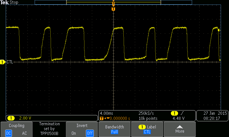

    6. What does the CTL pin look like when the circuit is misbehaving? Does it oscillate too (similar to the Vc profile)? This is also a sign of an unstable loop.

    6. CTL pin is also oscillating when circuit is misbehaving. I have also attached the waveform taken at CTL pin.

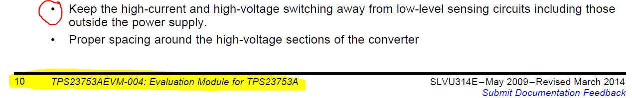

  • Please examine the layout difference between the previous working design and this PCB design especially with respect to routing of the CTL pin trace (pin 1 of TPS23753A). If the CTL trace is routed too closely to noisy switching signals then the loop stability will be affected. We have the following text in the TPS23753AEVM-004 user guide, but we should make it clearer about the sensitivity of the CTL pin trace/signal.
  • Hi Eric,
    Thanks for your reply. We checked the layout difference between two revisions of board. There is no layout difference for TPS23753 and output (op-amp, mosfet) section.
