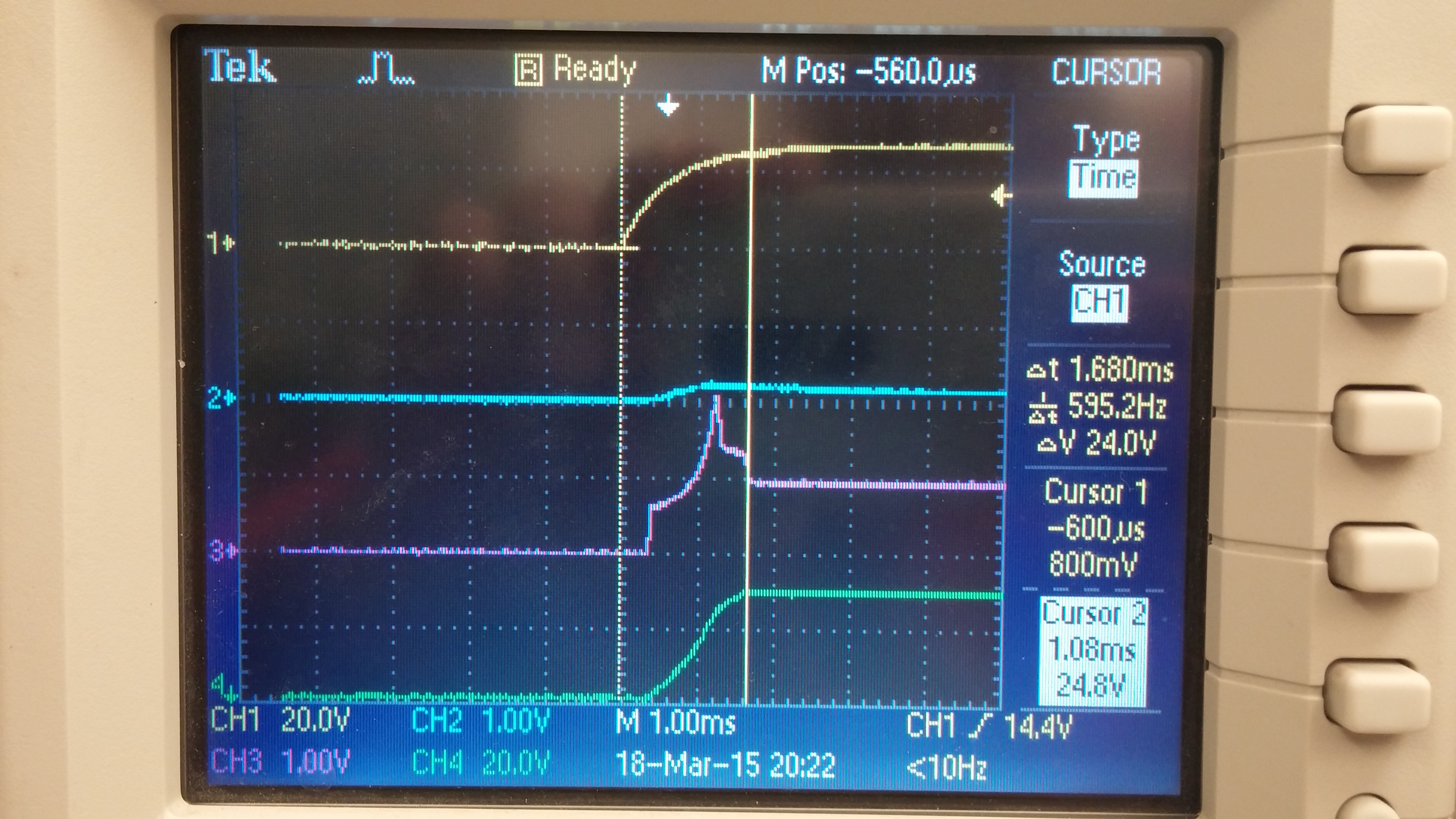

First, I didn't undestand the setup for 1.2uS.
Second, I attached 2 pictures that shows the respons of IMON according to UV enable.
Channel1- UV enable
Channel 2- Timer
Channel 3- IMON
Channel 4- VOUT
1 picture is without any load and the second is with 2A load whaiting.
Can you please explane me the strange response of the IMON?
Shmuel,
The fast trip response time setup is as follows: Connect PROG to VREF (4V) and OUT to SENSE. Connect GATE to OUT with a 2nF capacitor. Quickly slew the voltage between VCC and SENSE from 0 to 200mV and GATE will slew low quicky within 1.2us maximum.
Regarding the IMON waveform, this is the power limited current response waveform being controlled by the TPS2492. You can see this current reflected as the actual FET current during startup shown in Figure 13 and 14 of the datasheet.
Eric,
The behavior of the IMON is very strange. I didn't understand why the IMON is jumping so high and then after 2mS from power on the IMON set the right current value.
I'm using in design the IMON as input to a comperator with DAC and this behavior sets errors.
Please explain again.
