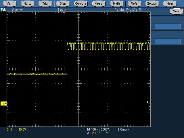

6. TPS2384 is supply the power to PD, normally.  Below is the waveform of N-pin at this time.

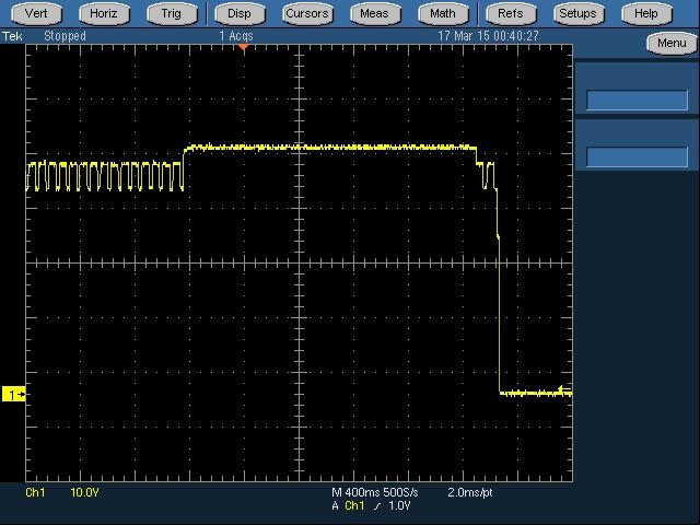

9. But, TPS2384 is NOT supply the power to PD.  Below is the waveform of N-pin at this time.

12. After Back-off time (2 seconds), TPS2384 is re-supply the power to PD, normally.  Below is the waveform of N-pin at this time.

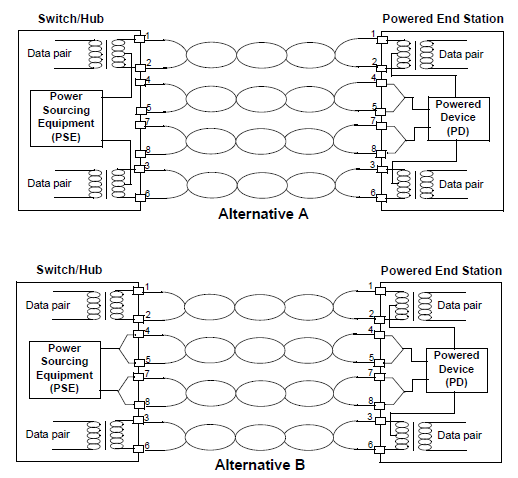

  • Would you be able to confirm whether the PD controller which fails is a type 2 per the IEEE 802.3at-2009 standard? As part of the mutual identification between PSE and PD types (now there are two types; 1 and 2 for 15.4W and 30W at the PSE), a type two PD controller must detect two classification pulse events from a type 2 PSE (a type 2 PSE that implements two-event physical classification). As part of this sequence, there are two MARK events and the MARK event voltage falls within the detection event voltage range. When a type 2 PD sees a voltage transition from the classification range to the mark range, the PD will present a resistance signature which is invalid with respect to detection (maybe ~12kohm).
    Here is one explanation based on the above comments:
    1. A type 2 PD is plugged into a TPS2384, ALT A PSE port. The TPS2384 port open circuit voltage is normally ~22V.
    2. When the PD makes contact, the port OC voltage falls from 22V down through the classification range into the detection range. This voltage drop/fall can put the type 2 PD into the MARK resistance range (~12k).
    3. When the TPS2384 is in ALT A mode, there is no backoff time between detection tries (4.4V to 8.8V to 4.4V to 8.8V continuously).
    4. When the TPS2384 is in ALT B mode, there is a backoff time and the port voltage falls much lower than 4.4V. This is probably enough to reset the type 2 PD out of the MARK state and allow it to present the normal 25kohm detection resistance.
    This is one possible explanation of the behavior, but the TPS2384 measured detection registance would have to be extracted from the TPS2384 registers when the failure occurs to be sure.
