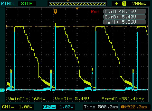

After probing certain signals, VDD is 53.6 Vpp 0.5 Hz, GATE is 0V which leads to switching MOSFET to be off and converter is disabled. Vc oscillates from 15.2 V to 8.2 V at 6.58 Hz for 1 second and then drops down to 0 V for 1.5 seconds, and repeats.

    I have here 3 boards. 2 EVM's, 1 Rev B which is working, 1 Rev A and a custom board, both of which exhibit the periodic drop of VDD from 53.6 V to 0, at a frequency of .5 - .7 Hz. Both EVM's are not modified, but the custom board is. Using 2 different PSE's, a commerial switch using PoE and a Netgear GS510TP with PoE+. Both PSE's produce the same results. The 5V output has just an LED indicator with a 1K resistor, no other load is connected as of yet.
    While probing VDD-VSS during start up on the custom board, it rises to approx 6 V and then drops back down to 0 V, which tells me its a detection issue.
    While probing VDD-VSS on the working eval board, it does the same and the board does not power up, but if I remove the probes it powers up and D2 and D17 indicate the converter is functioning.
  • Testing with multiple PSE sources, the eval board only has issues with the Netgear GS510TP during probing, but works fine with the other PSE's.
    Attached is a screenshot of the VDD-VSS output (CH 1) and Vrtn-VSS (CH 2) of the custom board with a PSE that the eval board functions correctly with. The probe is set to 10x attenuation so the voltages are just 1/10th of the actual values. Still not sure why the voltage rises to 53V and drops down only to repeat itself.

  • Since the PSE is able to turn on to 54V means the detection and classification is working and thus the PoE section of the PD might be okay. It may be the DCDC converter section that has issues.
    You may need to check the board that the correct components and values are assembled and there are no shorts causing the converter to hiccup. A side by side impedance comparison with the EVM might speed things up.

    Was able to figure out the problem, the Optocoupler in the feedback portion of the circuit was mirrored with the phototransistor and LED were on the opposite sides. Flipping it results in VDD-VSS no longer dropping, and GATE switching at the 250 KHz.
