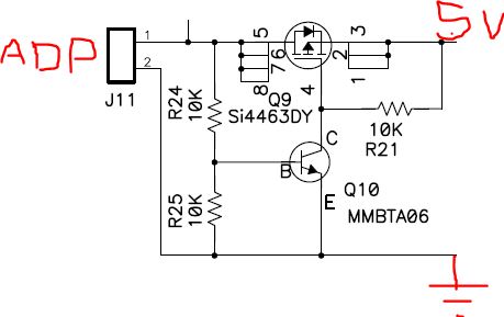

Hi Eric,
thanks for your answer. Do you have a reference schematic for using a P-FET to switch the adapter power in? We indeed need as close to +5V downstream as possible.
We would give adapter power priority over POE. It would not matter if the switch would drop POE due to getting below the MPS limit.
Michael
