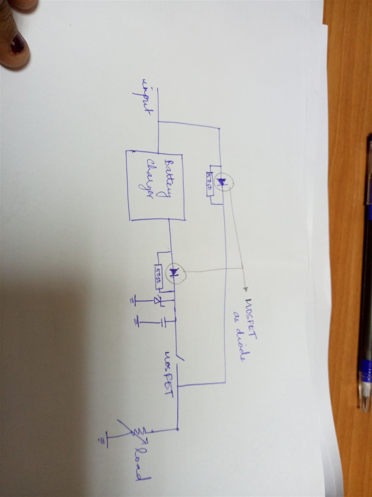

  • Dear Alex Sir,
    Thanks for your feedback - it was useful. I have checked with customer and got complete info as below, please help to advise your inputs.

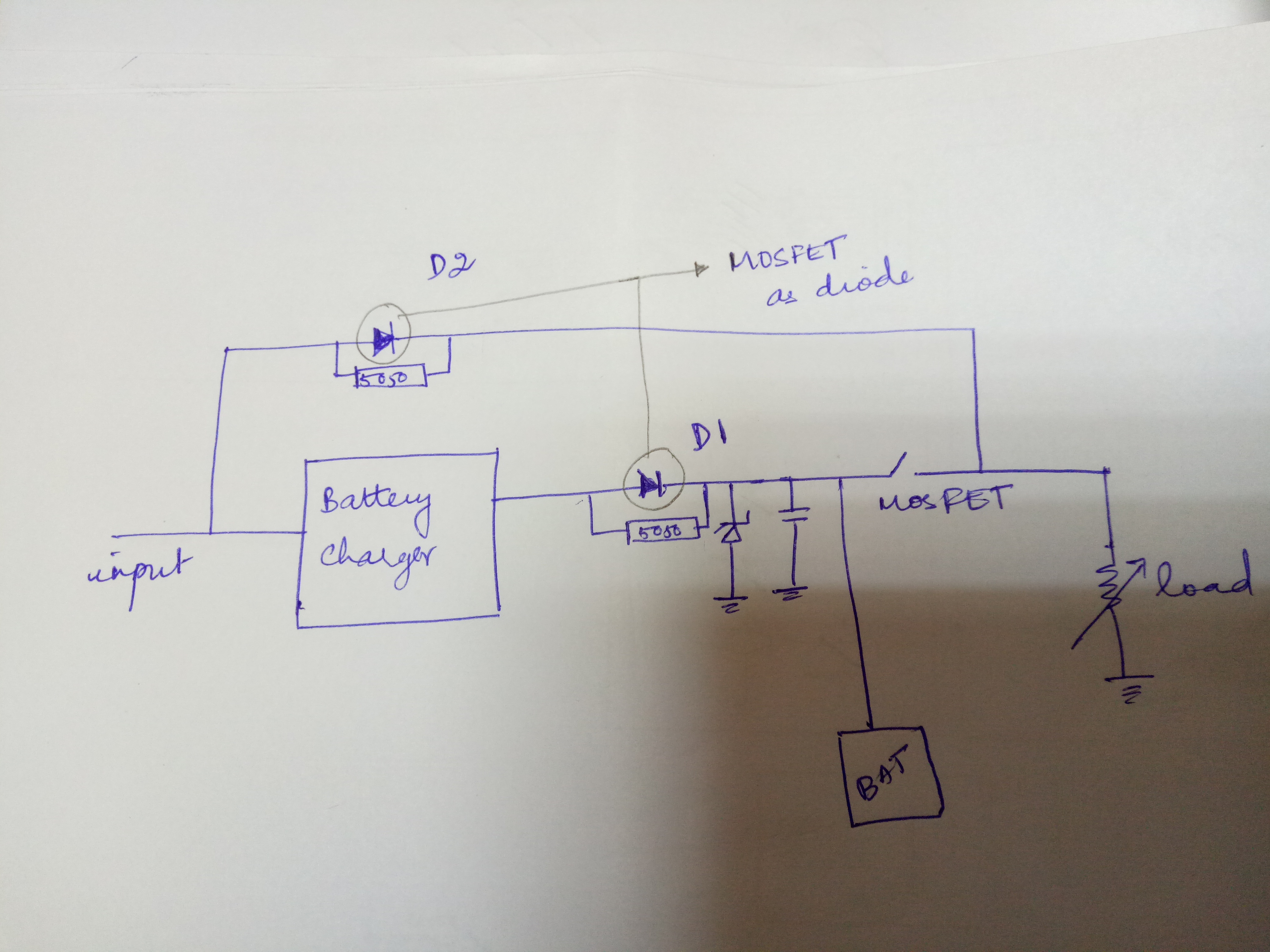

    Customer using LM5050 controller to use MOSFET as diode. They are facing an issue where in the controller gets damaged when the load is short circuited. They have only battery connected. There is no input being fed. Their short circuit protection circuitry continues to work.  There is a FET after this diode D1 which is fine but LM5050 connected to diode  D1 is getting damaged always.  Sometimes even the MOSFET which acts as diode D1 is also getting damaged.
    Kindly please advise how to go about resolving it.  Need your valuable inputs sir. Attached handsketch of circuit diagram for your kind reference.
    Rgds,
    Aravind.

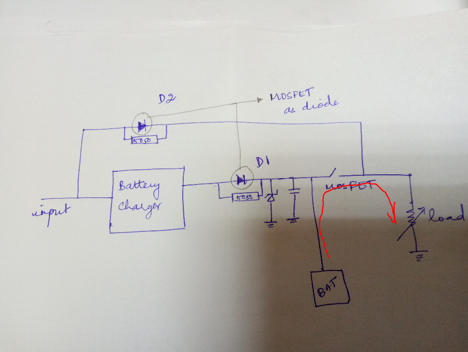

  • Hi Aravind,
    Thanks a lot for the diagram, it helps a lot!
    If I understand correctly, they have the BAT connected, the load is a short circuit, and they have a short circuit protection switch (fuse/electronic fuse/MOSFET) which opens in that condition?
    So the path of discharge is as follows:
    And after the fet/fuse/switch opens, the LM5050-1 connected to D1 is getting damaged, sometimes the D1 MOSFET itself?
    I will think it through some more and discuss with our team but first want to make sure we understand the setup.
    Also, is that device on the BAT line a TVS or a schottky diode? And can you provide the part number?
