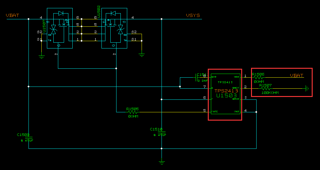

TPS2419 does not work when Va<9V?
Other Parts Discussed in Thread: TPS2419, TPS2411, TPS2413
Hi All:
We are now designing a product with DC power supply. We choose TPS2419 to manage the backup battery supply .So that TPS2419 will driver the N-MOS to swith on the battery supply when the DC is power off. The schmatic shows as blow. When Va>Vc and Va>9V, the gate will output 16V. But when Va>Vc and Va<9V. the gate pin just stay low whenever Va>Vc or Va<Vc. Why does not the gate pin output high level when Va>Vc as well as Va<9V?
