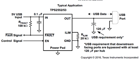

Hi Wang,
Some of our relatively old devices do not have layout guidelines like TPS2063, but we have those guidelines on new devices, so I am attaching a layout guideline for a similar device to the TPS2063 which is for the TPS2552, notice that (FAULT Bar) signal is the same as (OC bar) signal you have in the TPS2063.

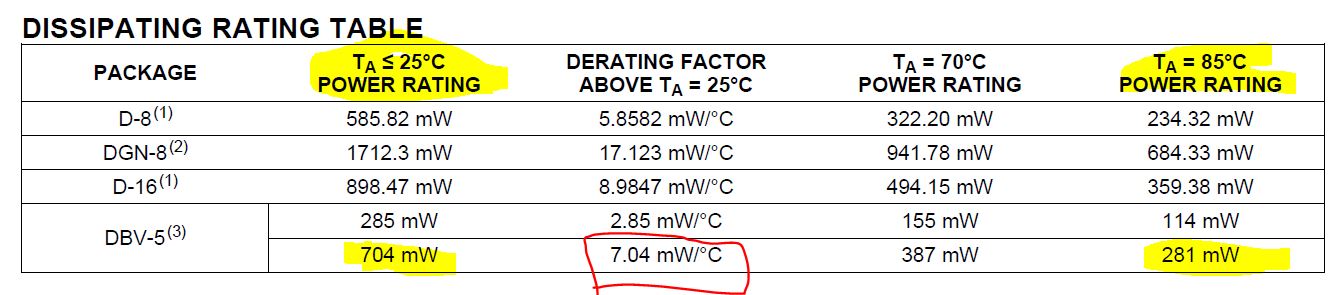

Hi Haidar
From the TPS2063 datasheet page 3 DISSIPATING RATING TABLE the DVB-5 package TA ≤ 25°C POWER RATING are 285mW and 704mW
Per my understand the difference between the two POWER RATING should be related to the layout.
How do I confirm when I use this package power rating can be achieved 704mW .
Hi Eric
DVB-5 package power rating there are 285mW and 704m what is the difference when TA ≤ 25°C?
