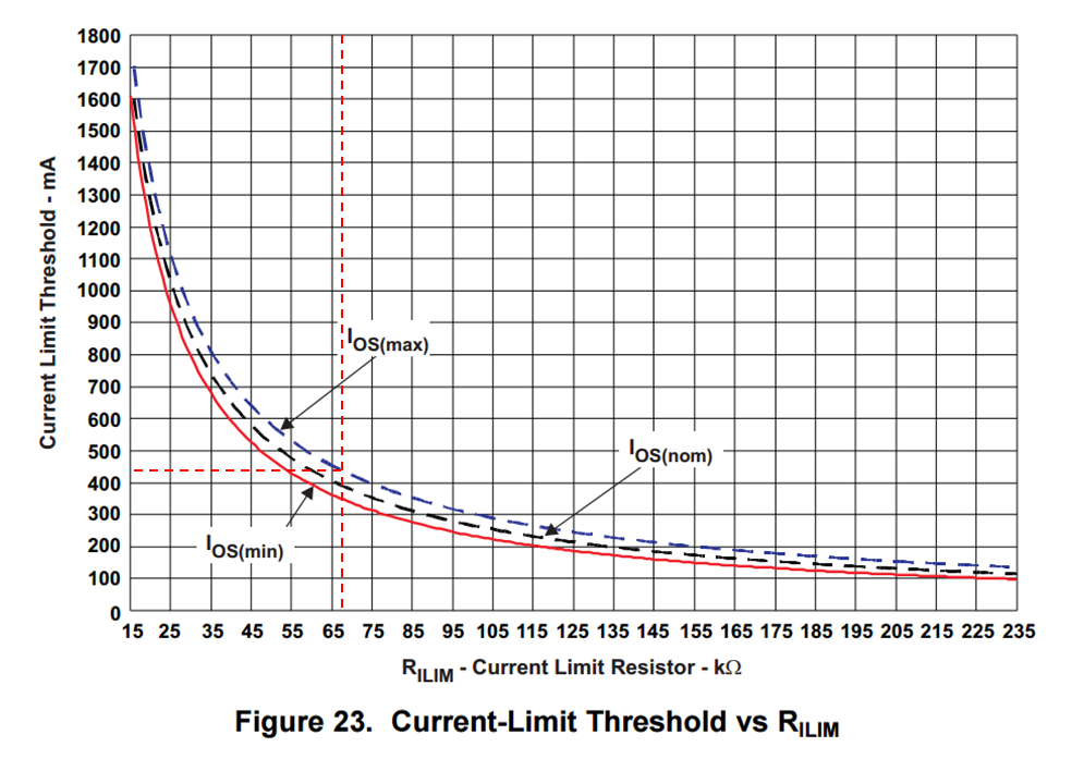

We got a question from customer about TPS2553.
Could you help us?
[Question]
- How much is the variation of current limit by Rilim=66.5k at the over temperature?
  My customer need the vriation falls within the range 300mA to 500mA.
