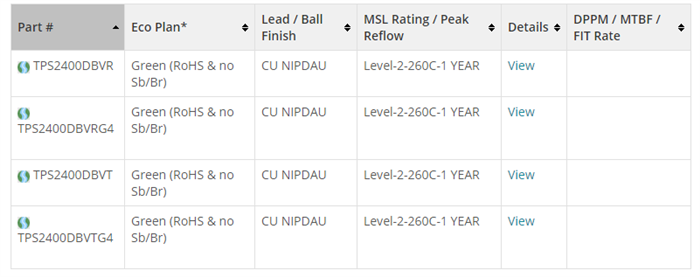

Dear Team,
we got the request for missing reliability data of the TPS2400DBVR.
Indeed the part does not have the information online:
Could you please help on this?
Thanks and best Regards
Martin

Hi Martin,
I am working with our quality team to see if we can get this information.
Thanks!
Alex
Hi Martin,
We were able to track this down and are working on getting it updated in the tool.
Material |
MTBF |
FIT |
Usage Temp (C) |
Confidence Level (%) |
Activation Energy (eV) |
Test Temp (C) |
Test Duration (Hrs) |
Sample Size |
Number of Failures |
TPS2400DBVR |
1.2E+09 |
0.9 |
55 |
60 |
0.7 |
125 |
1000 |
13387 |
0 |
Thanks!
Alex
