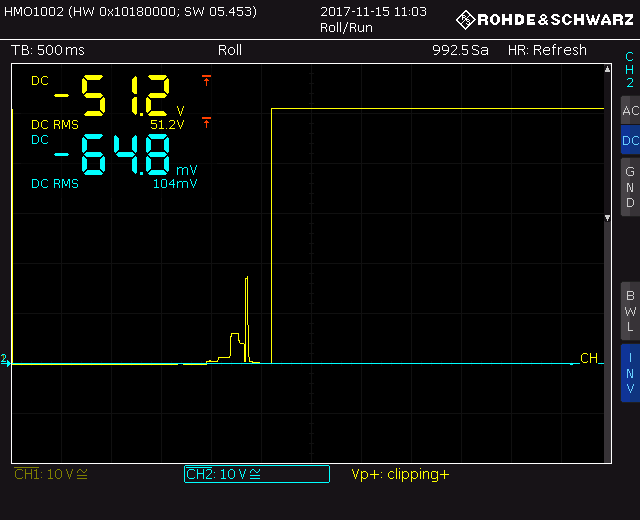

I have a PoE PD setup based on the power-part of this reference design: https://www.ti.com/tool/TIDM-TM4C129POE.
When I connect an external 12V adapter, everything works perfectly fine. A cheap PoE midspan power supply also works well. Only when I attach the device to a PoE Switch (lancom G2326p+) I see the following behaviour:
The detection and classification works and the PSE supplies 53V (measured between VDD and VSS).
Unfortunately the TPS doesn't switch open the MOSFET to connect RTN to VSS. after a couple seconds the DC/DC converter gets very hot (I assume because there's no feedback from the secondary side and the duty cycle approaches 100%). Some seconds later the either the overheat-protection kicks in or the switch detaches since there's no valid MPS.
The only difference I could measure between the midspan power supply and the switch so far, is that with the former I get 48V between VDD and VSS and with the latter 53V.
Any suggestions would be greatly appreciated!

  • Hi Tom,

    What happens with the cheap midspan PSE is this (yellow is VDD/VSS, cyan is the secondary side of the transformer):

    I see if I can post an oscilloscope-screenshot of the PD attaching to the switch.

  • Okay, so I solved my problem, I guess.
    Look at the screenshot of the PD with the switch as PSE: notice the negative voltage?
    Now here's the thing:
    I had to invert the signal, because I didn't have a differential probe at hand so I ref'd the scope's GND (PE) to VDD while probing VSS. The other way 'round it wouldn't work.
    Looking a little closer I saw, the RJ45's shield on my prototype was accidentally (I know I said I triple checked - well, sometimes it takes a fourth time, I guess ;) )
    connected to the TPS23753's RTN ground plane.
    Since the switch has PE connected to its RJ45's shield (as it's supposed to), when plugging in a shielded CAT5 patch cable RTN got pulled to mains earth.
    The midspan supply didn't have a PE connector (I said it was cheap), so the problem couldn't occur.
    Now, to put an end to this:
    can you help me understand, why it is a problem when VSS (or RTN) gets pulled to mains earth (PE), but not VDD (as I did during probing with the scope)?
    Thanks in advance, Sebastian
