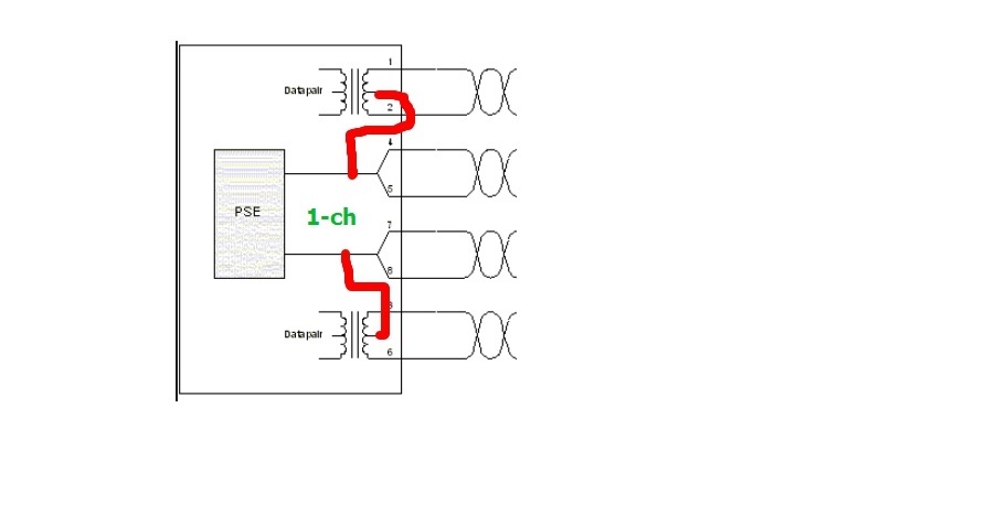

We are developing PSE to support PD IEEE802.3af (15.4W). Normally, our PD <10W.
We would like to check. Can we use TPS23861 single port to develop 4-pairs in parallel ?

Hi CCphi,
Technically it can work but it is not compliant to standard. For PD<10W you don't need to use 4 pair actually.
Can I know why you would like to use 4 pair?
