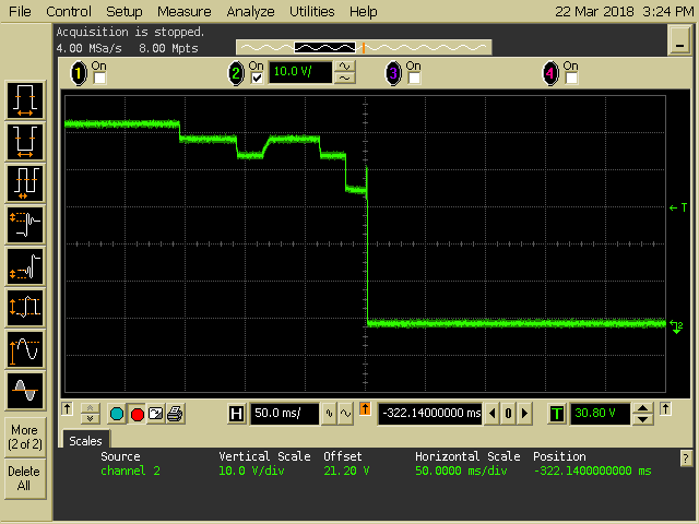

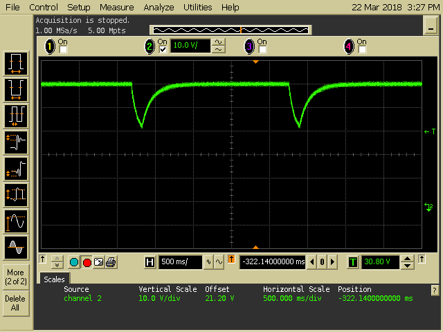

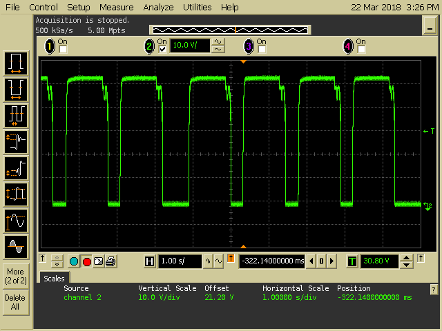

When I probe the N pin of a failing port I'm getting the following:
Discovery
Classification and power on
Then I see constant removal and application of power
I'm assuming the tester is just trying over and over again. The only consistent failure mode I've seen is the failing port unable to deliver as much power as the non-failing port. Failing ports won't give me more than 13W when testing class 4, but a good port provide the upto 20W (even though it's only a type 1 PSE).

    I adjusted the Fluke to test Class 0, 1, 2, and 3 - all fail. I get various failures (sometimes 0V unloaded and/or mode not recognized), but the power is always consistent at 13W. The scope captures are from testing with Class 3.
