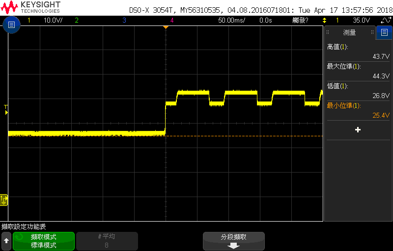

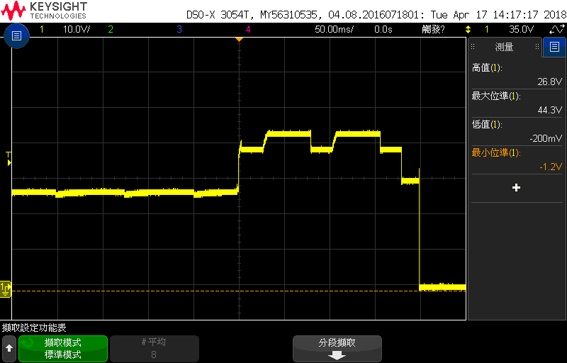

  • Hi, Penny
    We found there is a symptom that TPS2384 can't detect PD IC Si3402-B when setting this parallel capacitor as 0.22uF.
    The capture is as below:
    When changing this capacitor as 0.1uF, Si3402-B could be detected and capture as below

  • Hi Ruei-Ming,
    What's detection results when the port cap is 0.22uF and what's the port cap on the PD side? If the port cap is too high it may fool TPS2384 to get the wrong detection result as TPS2384 relies on the port impedance to reduce the detection voltage from 8.8V to 4.4V. Large port capacitance across the port may cause the detection algorithm to be fooled.
