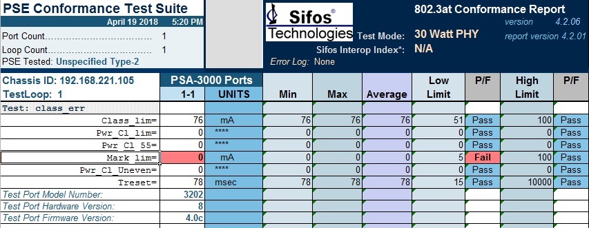

TPS2388: Classification failed whild Sifos test
Part Number: TPS2388
Now using Sifos test instrument as "normal" PD device, TPS2388 could identify it as class4 PD and provide power.
But when using Sifos test instrument as "Sifos testing" PD device, TPS2388 could only identify it as class0 PD, and show the report below.
(BTW the report is the same if test by TPS2388EVM)
Could you help to heve some comment? Thank you.
