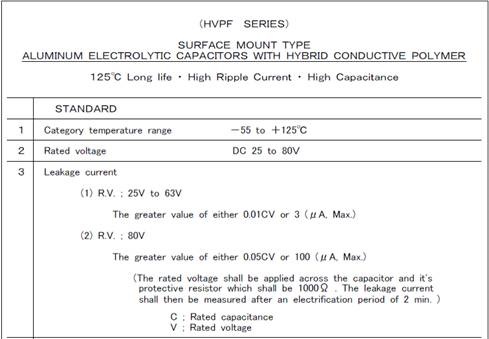

The device was MP already and got some devices needs RMA. This device failed while operate in low temperature condition (under 0 degree C)
Could you please help to check that is there anything can fix this issue, thank you very much.
Schematic: AP-MT7621 _ 17-Power POE_cold boot issue.pdf
Attach cap's spec as below
