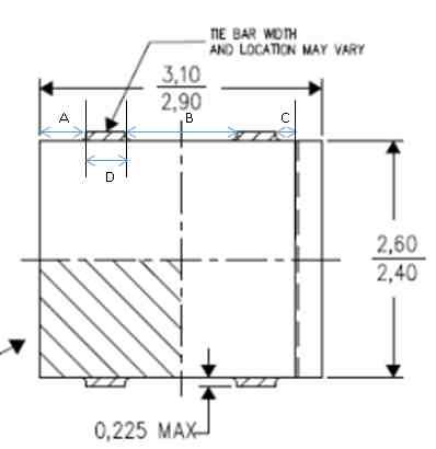

Could you tell me how long is length of following A, B, C, D for our reference?
Kuramochi
Kuramochi
Kuramochi-san,
I have reached out to our packaging engineers. I will get back to you soon.
Hi Barr-san,
The sum of these length is 2.725mm such as following.
→0.494mm+0.412mmx2+1.188mm+0.219mm=2.725mm
I think that this value should be over minimum length(=2.90mm).
Are these value correct?
Kuramochi
