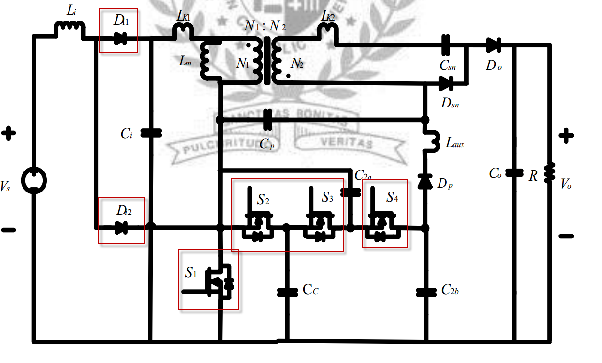

Hi Team,
May I know if TI has suitable MS driver solution for this isolation application? Customer is looking for MOS driver that integrates the diode and MOS in red square.
Andy Chu
  • Hi Andy,
    Thanks for reaching out to us about this driver application. All of our drivers are pre-drivers which do not integrate the FET however there are load switch drivers among others which integrate the FET. In some of our half bridge drivers we integrate a boot diode. But this internal diode does not see any power train current. Can you tell me more about the application, what type of converter is this? is an isolated driver required? Are S2-S4 highside switches? (S1 is a lowside and can be driven with one of our drivers directly)
