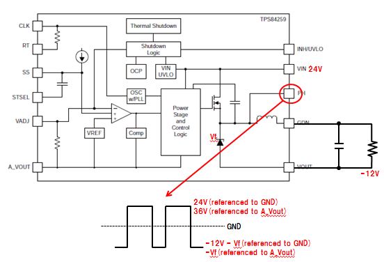

 My customer has question about PH rating. In datasheet, PH voltage rating is referenced to GND.
 But my customer is thinking, PH voltage rating is referenced to A_Vout. Because when FET turn-on, PH voltage is close to VIN and when FET turn-off, PH voltage is close to Vout.
 If datasheet is correct, when FET turn-off, PH voltage is close to Vout. That’s mean PH rating is over in some cases.
 Could you tell me about PH rating.

    Great question.  The max. PH voltage rating 45V, as in the datasheet, was referred to GND.  The max. PH voltage rating, if referred to A_Vout, was over 60V.  Since the max. Vout (same level as A_Vout) for this part was -17V, the total PH voltage to A_Vout would be 62V, which was still over the spec.

  • Thank you for your help. When Vin=24V, Vout=-12V, PH voltage is referenced to GND is -12 - Vf V to 24V. If Datasheet is correct, we can't use this device in this case.
    But If PH voltage is referenced to A_Vout, PH voltage is -Vf to 36V. We can use this device. Could you tell me about PH rating?

    The voltage rating in the datasheet are always referred to GND, unless else stated.  The absolute max PH voltage, as referred to GND, was 45V.
    If referred to A_OUT, the max PH voltage rating would be 65V.
